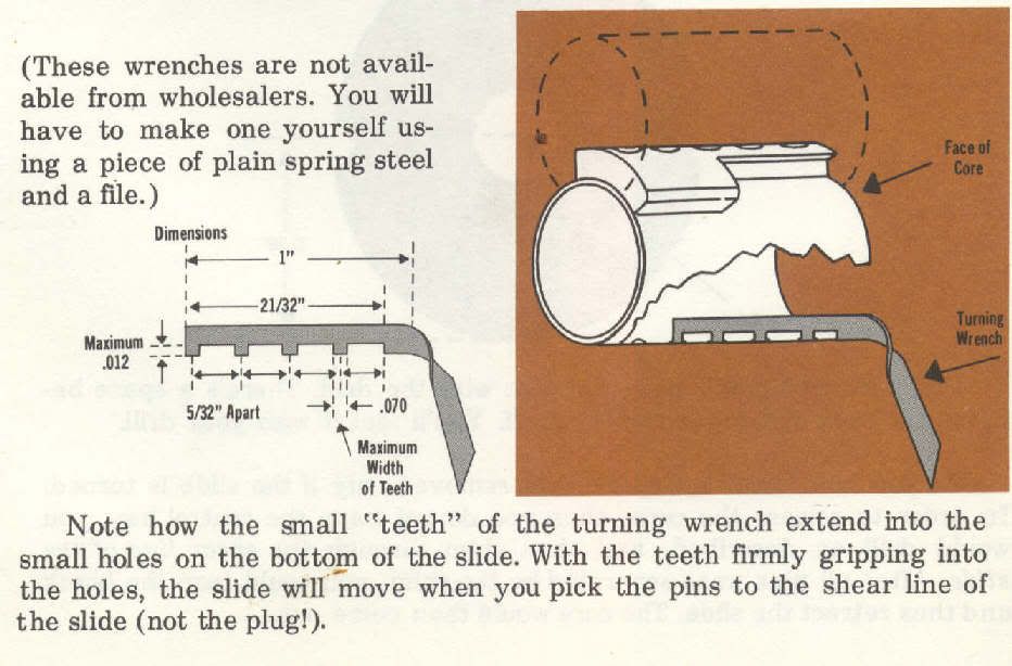

Postby LockNewbie21 » 4 Jul 2006 23:36
Best small format interchangable cores are not that tricky if you research and get/ make the right tools, to pick the control line i belive it is there is a thread with the picture and measurment of the tool. First to make a control key, you must determin the correct key way you can do this by looking at the warding and then matching it in a key catolouge<--spelled wrong, Best has quite a few key ways and key size's (Length reflects number of pins) then decode or impression the lock and create the control key. I cannont claim the simplicity or difficulty of picking one as of yet, i only pinned them and created a master key system for 5 diffrent cylinders for training and practice. As i understand and was taught best SFIC''s are used because of there very good ability to preform in a master or grand master system.

Postby unbreakable » 5 Jul 2006 19:32
unlisted wrote:
LockNewbie21 wrote:Best small format interchangable cores are not that tricky if you research and get/ make the right tools, to pick the control line i belive it is there is a thread with the picture and measurment of the tool.
Andy
Any idea as to the title, or thread location?
I looked, and could not find.... :(
I had a copy of the image on my hard drive, and I just posted it on photobucket. Here you go.
Credit and props goes to the author.
Unbreakable

Postby Octillion » 5 Jul 2006 22:55
Peterson does make these tools, by the way, so they are commercially available unlike the image states.
I bought them back when I was about two months into lock picking and was not successful in getting them to work, however I have not tried them out recently, so I can’t give much advice to how well they actually work.
There are a few keyways these will not work on, at least not those supplied by Peterson, as the keyway warding prevents proper positioning of the tool.

Postby picksmith » 6 Jul 2006 22:39
Peterson now makes them in three different thicknesses and that is supposed to remedy the problem with them not fitting into certain key ways. I have also seen it suggested to put a toothpick in beside the tension tools that are too thin, and then break off the excess.
You can read about it here:
http://www.peterson-international.com/i-CORE.htm
