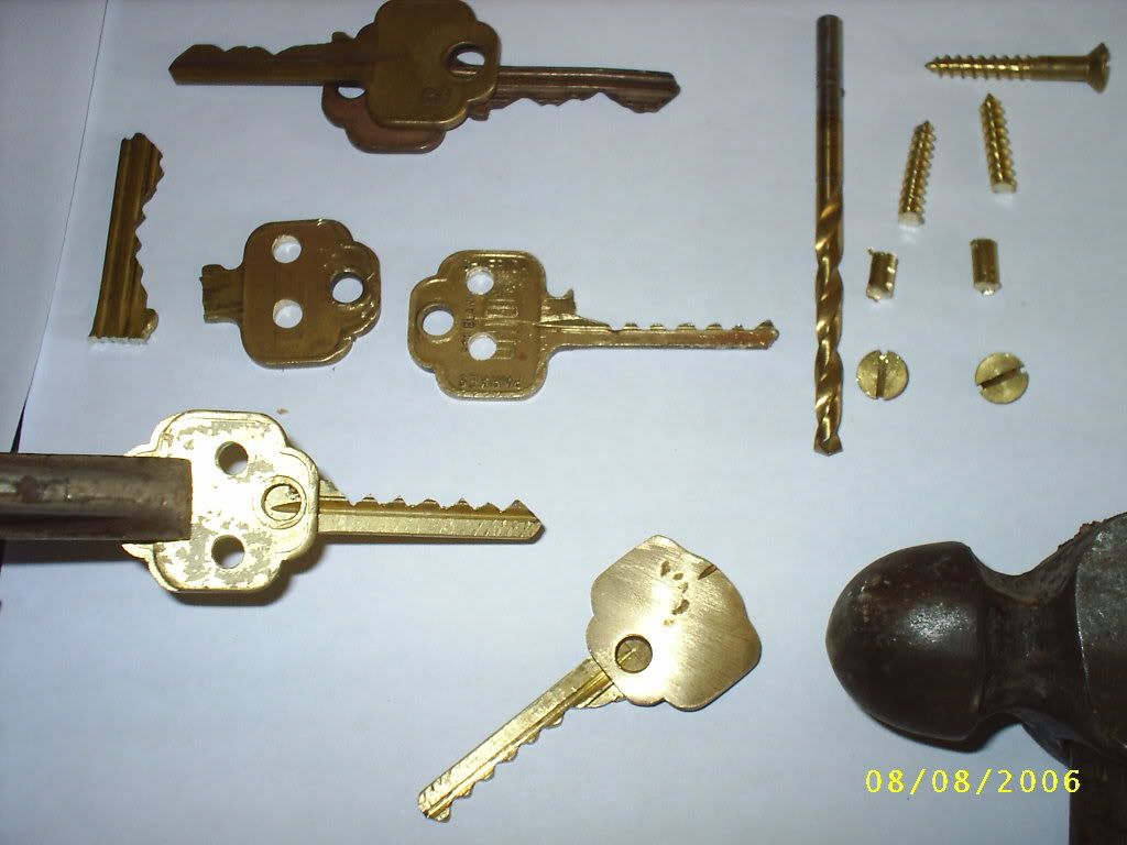

Hi everyone,
watching most of Barry Wels's video presentations, i decided to
make myself a bumpkey. as everyone know,once you're successfull
bumping your first lock you just want to make sure it was't luck so
you try again and again.

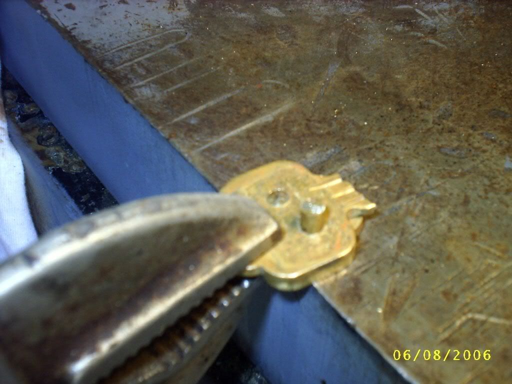

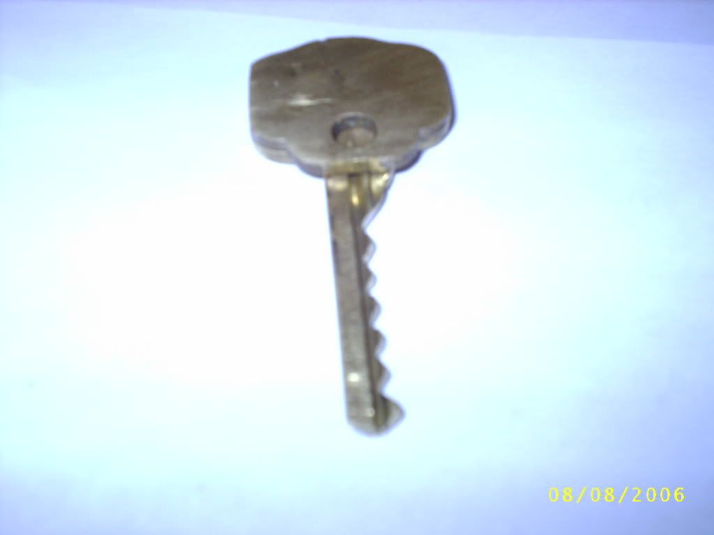

well working with a brass key, the shoulder broke off after i manage to the lock about 50 times,by hitting it with a screwdriver
i then decided tomake a tomahawk using a piece of pvc strip with
a piece of plastic in front. now i had my own bumping hammer.
not having any keys made of proper material i decided to make a new shoulder for my bumpkey.

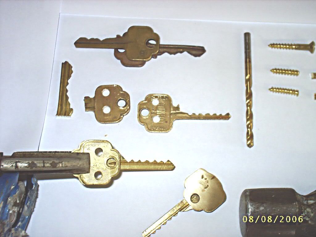

material and tools used:
dril
drilbit -same thickness as screws
vicegrip- to hold keys while drilling
hacksaw- to cut screws
grinder/file -to shape
hammer- to flatten
two brass screws
some spare keys
let's start:

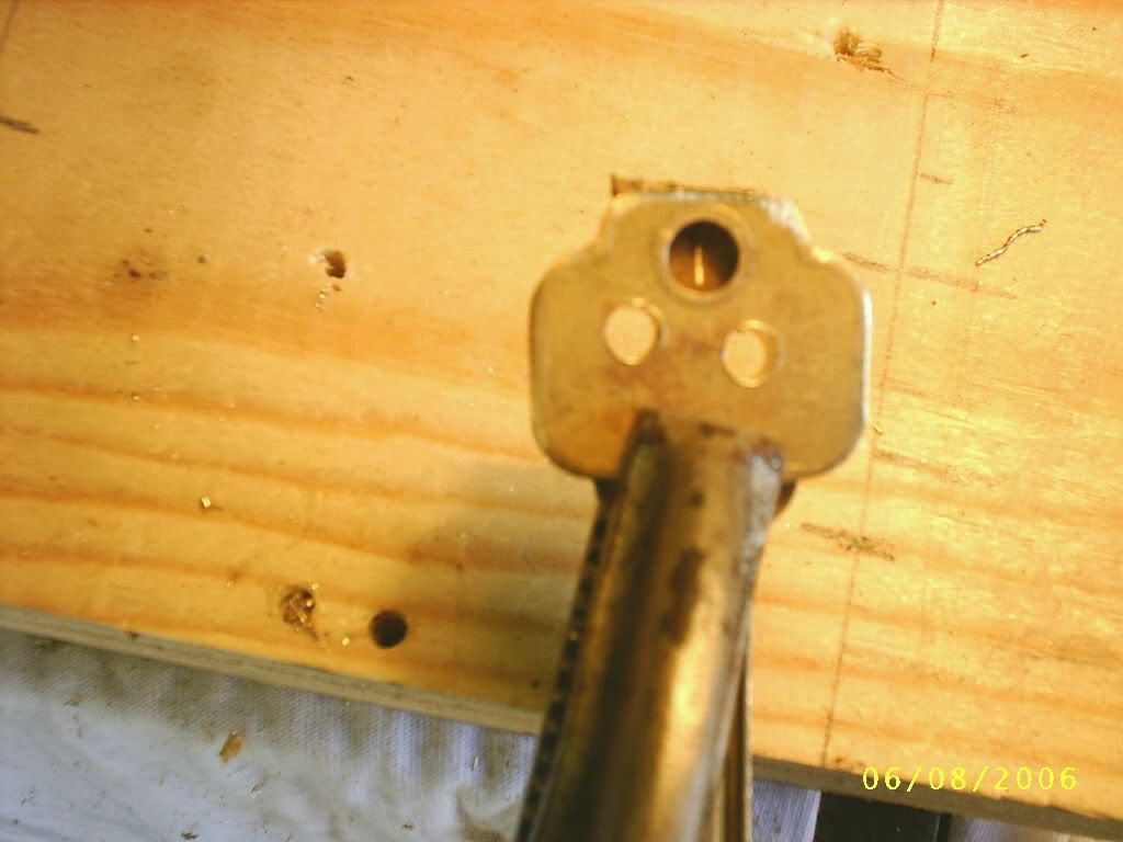

move key heads to correspond with existing shoulder or where
new shoulder should be.
now clamp both heads on top of each other.

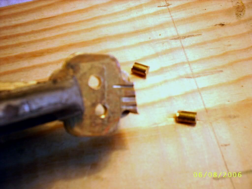

drill through both heads
use middle pices of brass screws and hit them through the holes
in the two heads

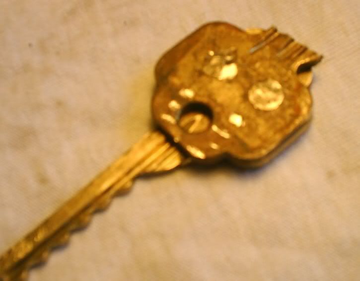

use ball of hammer and flatten both sides to ensure it won't come apart.
now grind or file the heads into a decent looking shape,then use sandpaper to smooth.
now i have a question?
having the shoulder n the side , won't it damage the inner cylinder
although it also rest against the outer hull.?
i am including photo's
i do hope the photos work as i am not sure to post photos
feedback will be appreciated
thank guys
fanie.[/u]

I have made loads of bump keys for loads of different keyways, and it is true that with some key profiles, once you have removed a bit off the shoulder, you are left with little metal left to withstand the knocking.
I understand you logic in strengthening the shoulder and a nice try.
Personally, as a locksmith, if i ever break the shoulder I just get a new key blank and cut another from my master.
Remember though that not all locks are bumpable, so repeatedly whacking them will no doubt cause you keys to eventually fail. Plus you will dent the face of the cylinder.
Having looked at your idea I might visit my workshop and see if I can create some universal 'plates' which I can attach to my keys to prolong their life.

You can use hot glue-gun-glue (yeah I know...) to make a new shoulder. This works OK, and gives some nice springyness. Wouldn't bother unless the original shoulder broke off tbh.

But I really liked your idea on reinforcing the keys.
