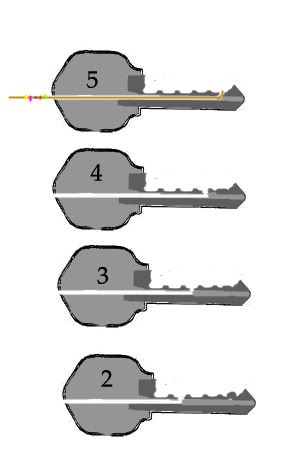

Postby GoodEyeSniper313 » 30 Nov 2006 1:54
ok heres what came up with
basicly u have 5 different key blanks with cut (999) with a routed groove going to a pin slot. each blank goes to a different pin slot. then a piece of music wire is inserted into the groove. the wire is marked to by color to show diferent pin sizes.
so u would simply pick the lock, then while its picked you insert blank #5 into the lock and push in the wire until the pin hits the cylinder wall if the wire goes in all the way to the second colored line u know that pin is a 2. so you know pin 5 is a 2. now ud put in blank #4 and repeat until you have all 5 measurements.
this is just an idea im not a locksmith and i dont know how practical this tool would be.

Postby zeke79 » 30 Nov 2006 2:11
The problem with using wires is that they are easily bent out of adjustment.
