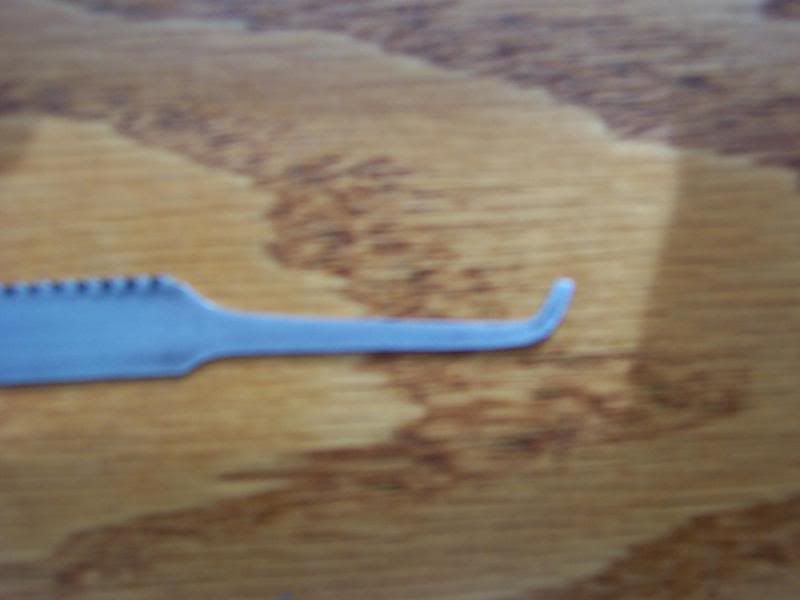

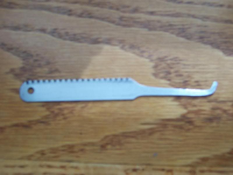

I just finished making my first pick.
http://img.photobucket.com/albums/v283/ ... 0_1304.jpg
http://img.photobucket.com/albums/v283/ ... 0_1305.jpg
The lighting and focus looked a lot better on the little display screen, but you can still see most of the details.
But anyway, my first pick, done free hand on a grinder. I'd appreciate any critiques. But if you have something negative about it, please give me a tip on how to improve upon it.

Looks kinda thick, but see how well it works, that is all that matters.

Postby Thano » 9 Dec 2006 15:04
the thinest part just before the bend is just about 4/32 inch, the tip is 3/32 inch.

sand, sand, sand. get some emry paper (fine and super fine) start with the fine work to the super fine, by the time you're done you should have it look like a mirror and make it a little thinner
Postby Thano » 9 Dec 2006 15:08
ok, so i'll make the hook a little smaller, and get the whole thing a little thinner too. Thanks guys, I'll get to work on it when I get back from lunch.

I'm just duplicating previous coments I suppose, but it does look a little thick, and the tip seems to be a bit too tall.
The overall shape is really good, and if you shave just a bit off the bottom of the shaft, and lop a bit off the top of the hook, it should be great.
After that, just sand like a mad man.
Personally, I would lose the teeth from the blade, but that's entirely up to you.
Good luck, and congrats on your first pick.

Also to improve upon the pick I would suggest making the angle of it a little less steep, it looks about 75 degrees, i would reduce it to about 40-50 by cutting off the top half and sanding/filing on the inside of the curve a little more than the outside. other than that its great :D
