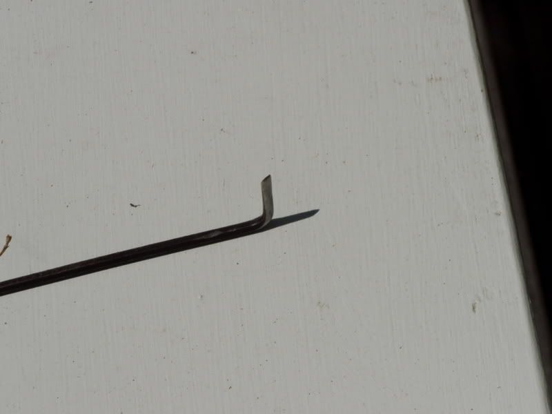

Here's my first (out of two) hex key torque wrench. I have now moved onto bigger and better things :lol: ---2.5mm Welding rods 8)

haha wow thanks for the tip. Its just that i heard reinforced steel (like those on hammers) could shatter if it was subjected to lots of heat and force (like those on a bench grinder), so i j ust wanted to make sure. Thanks for the information along with the picture :lol:
