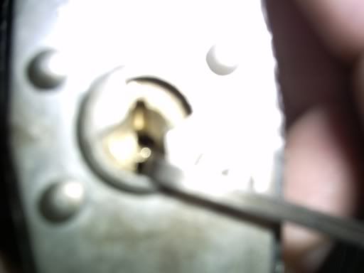

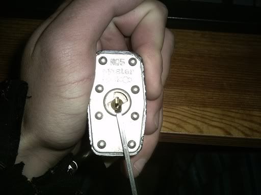

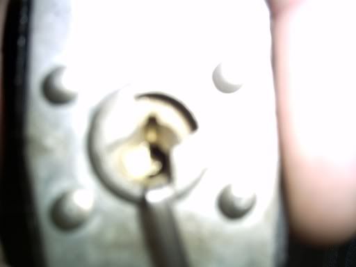

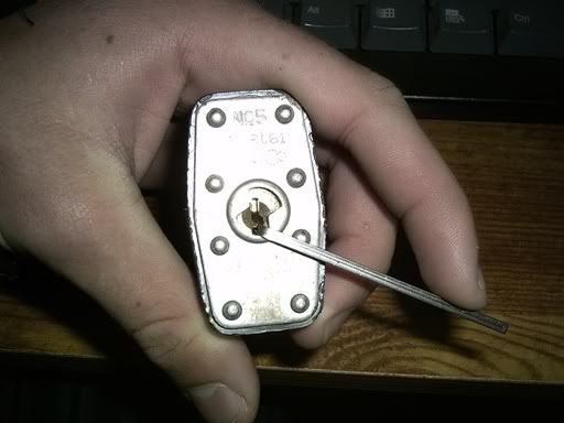

every time i try to pick master locks with tension wrenchs ive made from winshield wipers the wrench will slip when i start working in the lock with my picks and all the tension on the plug gets released and the pins fall back into place. does anyone have any tips to prevent the wrench from slipping like it is?
heres some pics
before pick is inserted
http://i29.photobucket.com/albums/c292/ ... G00014.jpg
after
http://i29.photobucket.com/albums/c292/ ... G00015.jpg
close ups
before
http://i29.photobucket.com/albums/c292/ ... G00016.jpg
after
http://i29.photobucket.com/albums/c292/ ... G00017.jpg

get a thicker wrench.

Postby Deathadder » 14 Jan 2007 15:46
yes, either thicker or wider
