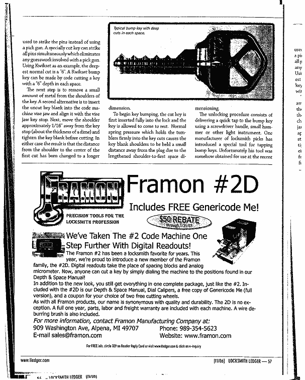

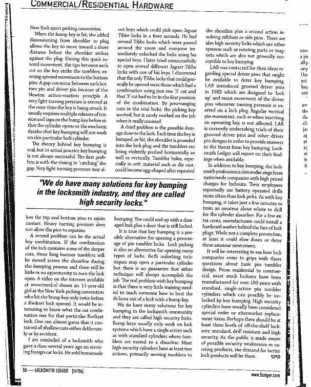

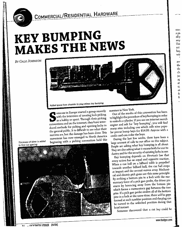

Postby linty » 9 Feb 2007 17:51
sorry about the quality, but it should be somewhat legible at least.
the relevant text is in the third column of the third page.
