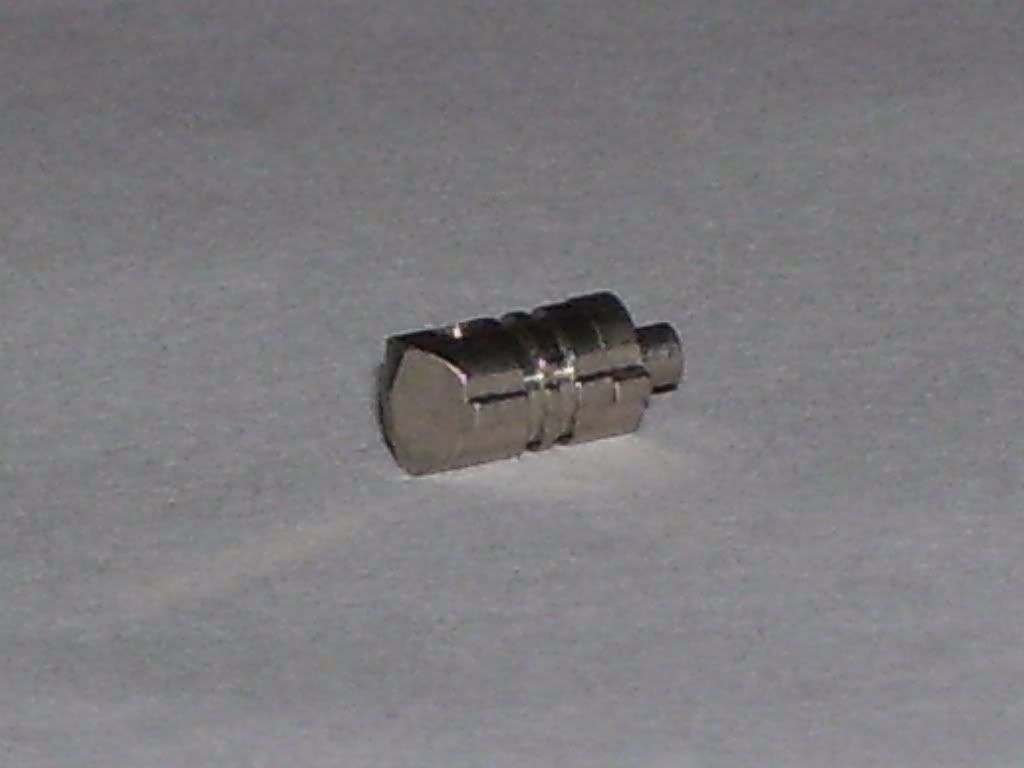

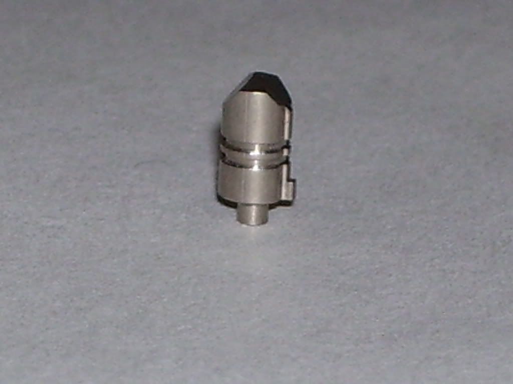

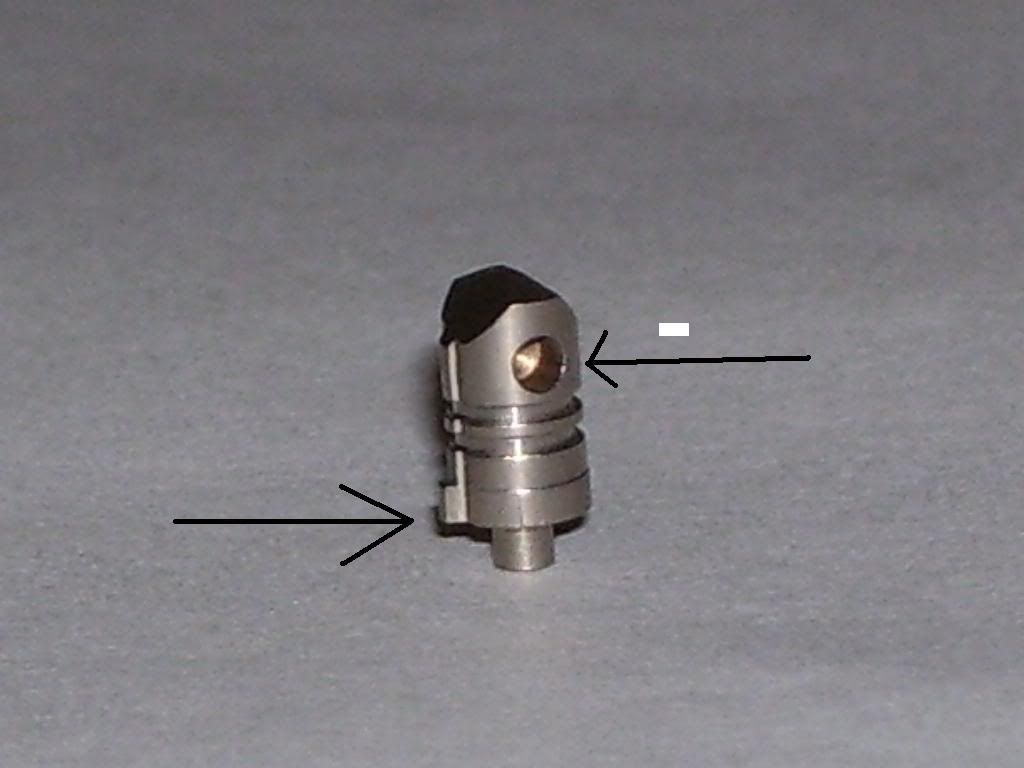

Postby jimmysmith » 8 May 2007 12:45
Here's a couple pics of a medeco pin.. you see it has the hole in the side for the sidebar gate to enter...also it has a little peace that protrudes off the side.. not sure whats it for .. it must keep the hole lined up or something.. then of course it had tat chissle tip...and also a couple serrated parts there in the middle.....
I have never has the chance to play with a medeco lock yet.. I dont know that i am ready for all that.. I am still tripping over side bars in general... but all in good time..
[IMG]
http://i160.photobucket.com/albums/t184 ... pin002.jpg[/IMG]
jimmysmith

Postby LockNewbie21 » 24 May 2007 22:32
Here is some piccs I posted in the advanced forums.. minus the picks used to open it even though there nothing special :lol:
So you noobs can get taste of the uber advanced forums :lol:
there ya go.

Postby raimundo » 31 May 2007 8:37
the pins in those photos are not from the type of cam lock I was discribing, they look to be from full size medeco cylinders, the cam lock is smaller, and the ones I have had apart do not have top pins, that first pin in the photo is a bottom pin as it has the chisel tip, but it also has the small post on top of it, which may be for centering a spring on, this may be a different type of cam lock from those I am familiar with, medeco makes changes without consulting me. :?
