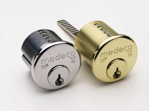

Postby l618 » 23 Aug 2008 12:55
That's pretty much the way medeco does it too :p
