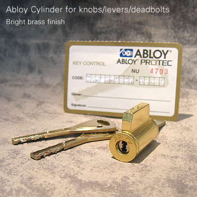

Thanks for the kind words! A KIK cylinder is a "key in knob" cylinder which may just be something we have here in the USA.
Here is a picture of a knob which was removed from a door, and the cylinder being removed from the back of the knob. Notice the slot in the knob, it allows the cylinders bible to have a place to slide in and it keeps the cylinder from spinning freely.
here is a kik cylinder from the front as seen if it were inside a Knob.
