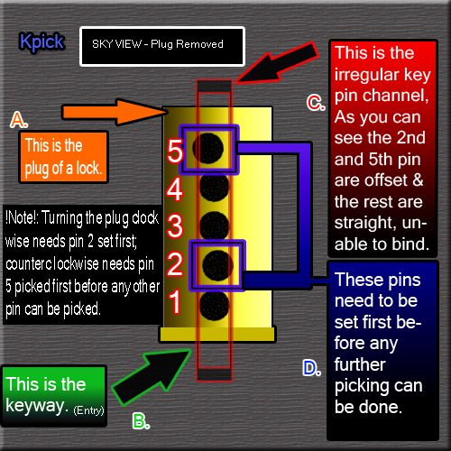

Postby KPick » 29 Dec 2013 20:18
Do you know about binding order? If not then you might be setting the binding order wrong. The binding order is the order that the pins need to be set in a given rotational direction. This image can apply in real life to most residential door-locks and padlocks (Pin Tumbler only). Let's look at this lock plug for example:
As you can see, some locks have irregularities in their drilling. This is because some pin holes were drilled offset in the manufacturing process.. (Oh well, nothing is quite perfect) This one isn't exactly like everyone lock, but this can be used as a good example. In this lock plug, you need to pick the 2nd or 5th pin before continuing to successfully open the lock, depending on the rotational direction on the plug. This is done by holding tension down on the lock (Clockwise or Counterclockwise) and feeling for a pushy pin, not a springy pin. If this lock works perfectly, you will hear a slight click, or feel a slight stop coming from a single pin. Make sure not to push the pins too hard.Hopefully this helps! Good luck.
KPick

Re: What's happening? [pins lifted up but none binding]
Postby mechanical_nightmare » 30 Dec 2013 9:42
HerrMannelig wrote: Try really heavy tension, and lessen it as needed.
I agree. Considering that the lock is functional and you are actually imparting torque on the plug (and haven't jammed up the tension wrench), it sounds like an issue concerning incorrect tension.
Nice illustration KPick!
