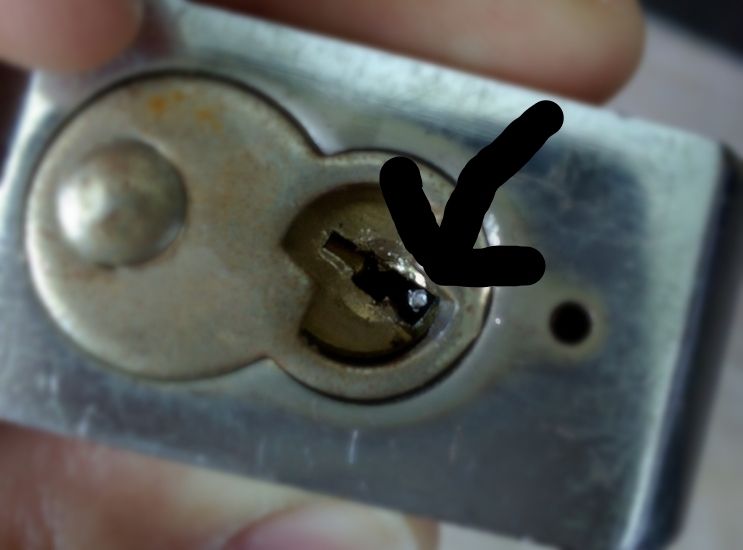

You wonder what exactly that is? Well I have a friend who custom pinned this Tuff Lock with an American core as a challenge because he knows I enjoy picking American locks and he made a bet that I couldn't pick it. I could get 5 of the 6 pins set but pin 5 would always bind regardless of what I did and I figured he made a driver pin or did something goofy to throw me off.
Today I was making another attempt and the key pin fell out into the keyway revealing what had been done. That " Driver Pin" is a rod that is too long to turn the core and was a booby trap. I tried to get it out to take a picture but the Wd40 helped me loose it trying to shake it out. If I find it I will post a picture and follow up.
After I got the shortened spring out it opened right up. I intend to act like I don't know what he has done and pick it in front of him with ease.

I'm just wondering what they did to the lock that allowed the key pin to fall out into the keyway.
This thing has had a rough life. They keyway is all beat up and it looks like a screwdriver assault. I am very glad it worked out like this though.
