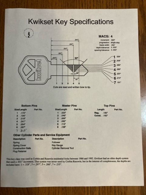

Actually there is a #7 key pin for Kwikset. It is only used in master keying. That is also why a lot of Kwikset pin kits have a #6 master pin.

.310”. It even has the same flat bottom as the other genuine KW key pins.

Forgot where I found this a few years back, but here is the specs.
