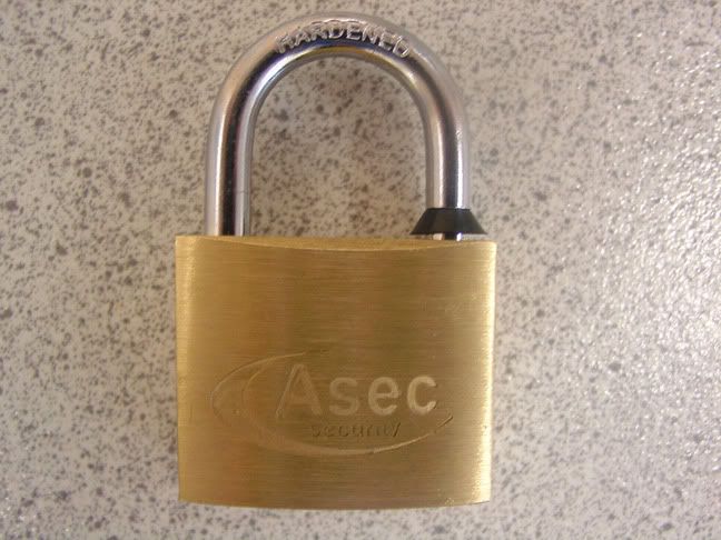

Hey,
I was wondering if anyone can give me any info on this lock:
http://i2.photobucket.com/albums/y36/RooJ/Asec.jpg
I bought it a while back and have only managed to pick it twice. Im wondering whether it has security pins as its a real pain to open. Opening via raking is near impossible as far as i can tell and many, many times ive thought all pins where picked but the lock just doesn't open :(. The packaging doesnt say anything about being pick resistant and it doesnt contain any identification / serial number for the lock either.
Thanks in advance for any info.

Assec is a budget brand but they can be a very tricky pick, not sure if it has spool pins but still a challenge . I stock the euro's and normal cylinders as they are great value for money and actually not bad quality.
Keep at it though and you will get it
:wink:

as toomush said, they are a budget brand, so it could be poor machining quality that means it is hard to pick. it looks like a nice secure padlock though, it could have a spool or serrated pin that feels like its set but isnt.

Their padlocks though are a doddle to pick. I've got some 40-60mm Asec pin padlocks and they fall open.
Hold the padlock so the pins are at the top, place a tension wrench at the top of the keyway in front of the first pin, being careful not to obstruct it, and apply tension clockwise, a bit more tension than a cylinder. Just give it a couple of rakes towards you and it should open...

Thnx for the info. Still no luck with it at the moment although i havn't had much time to try. Im not sure how much difference it makes to picking but I noticed that the pin settings (when looking at the key) seem quite awkward having a very deep cut for pin one, barely any depth for pin two and the cut for pin 4 is also very deep compared to surrounding ones.
I tried the raking method Evored and it does seem very effective but i never seem to get all the pins. Another thing is it seems very easy to overset pins on this lock when compared to the other locks i own.. Anyway im enjoying the challenge.. so im gonna go try again... and again... and again. :D

Just an update, i must of opened the padlock about 6 times in the last 2 hours (trying on and off) :D. I finally found a way to reliably pick it by gentle raking to start with (thanks evo) which seems to set about 3 of the pins on average, and then using a hook to pick the last pins, being careful not to overset them at any stage.
I love the feeling when you finally figure out how to beat a particular lock thats given you problems :), this one has really put up a fight.

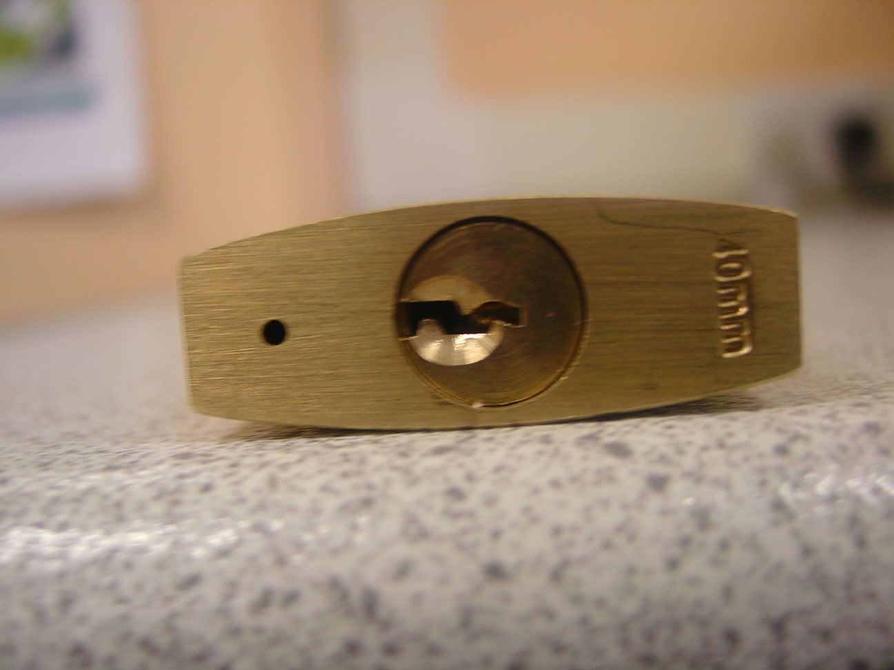

To anyone who owns an asec lock, i was just wondering is this a typical asec keyway?
http://i2.photobucket.com/albums/y36/Ro ... keyway.jpg
I guess after some more practice on this and my other locks ill be on the look out for my next challenge :D.
