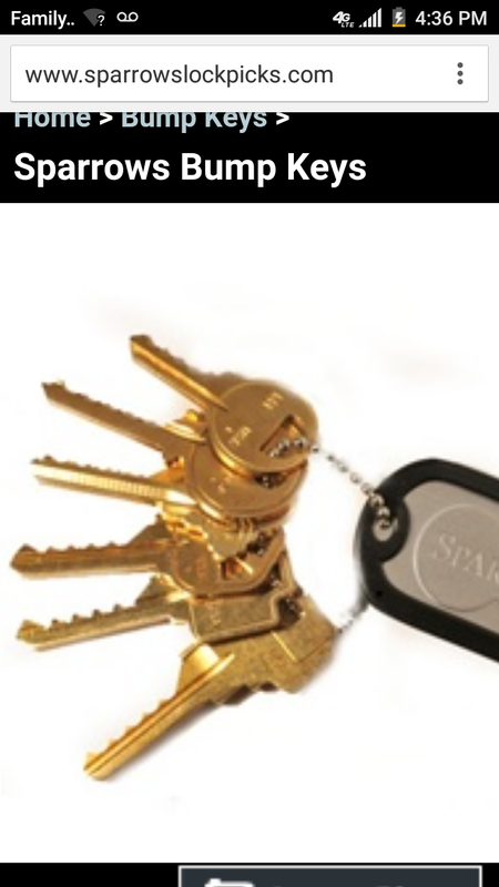

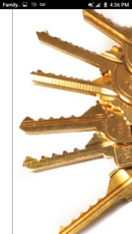

Postby sleepyrz » 19 Mar 2016 15:41
This is their standard set taken from their website 1 minute ago
And a closer look
sleepyrz

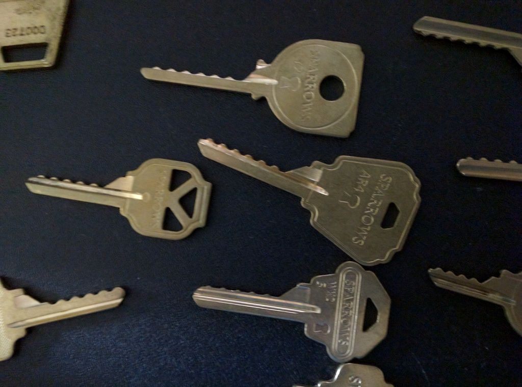

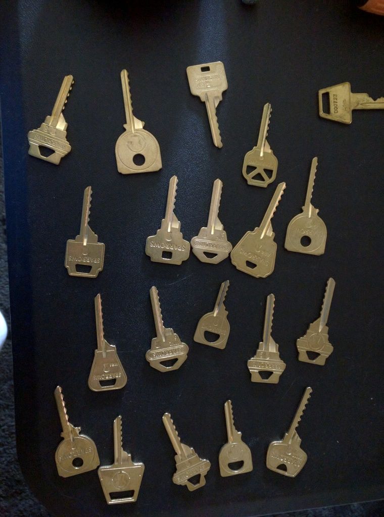

Postby jbrint » 19 Mar 2016 16:21
sleepyrz wrote:This is their standard set taken from their website 1 minute ago
And a closer look
These are of the actual product from my toolbox from 1 minute ago. I am not trying to argue but this is a bump key set.
