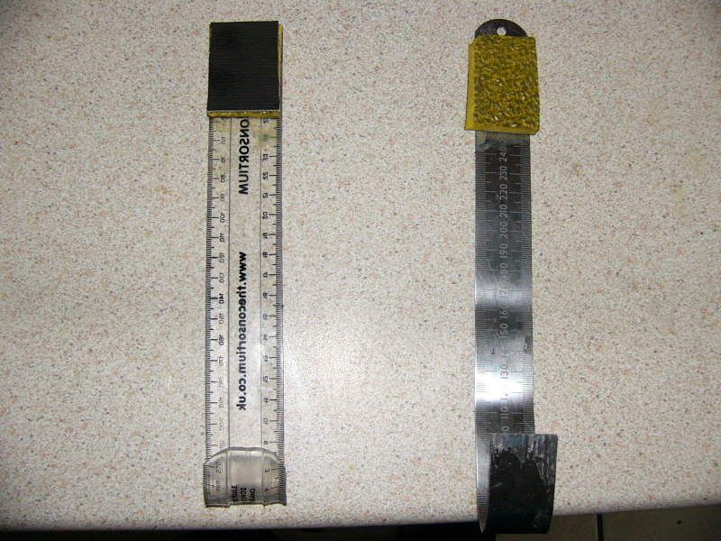

Postby peachey16 » 17 Mar 2006 12:52
ok ive had a look at a fellow lokies KeBump hammer and i had an idea.
as im still at school i get a lot of rulers come my way *coff* *coff*
so when i got hold of a metal rule and a flimsy plastic one this is what i came up with;
http://i30.photobucket.com/albums/c327/ ... bump11.jpg
http://i30.photobucket.com/albums/c327/ ... ebump1.jpg
there are untested but ill have a go this weekend and keep you informed.
the actual head is made from a rubber that is applied to the floor to lessen the impact of walking.
i think the look rather cool myself 8) 8) :lol:

Postby illusion » 17 Mar 2006 13:06
Yuk comes to mind...
The rubber bit at the end is really squidgy if it's like the stuff the have at my school... I drove one of my mate's head into it and it literaly bounced! In my defence it was provoked, an eye for an eye and all :wink:
So yeah - I think the rubber would absorb almost all the the impact so meaning you'ld have to make the handle onger ad swing it like a mace to get the lock to bump. :P
If it works then that's cool. :)
Postby peachey16 » 17 Mar 2006 13:44
actually the rubber is realy quite stiff
lp
