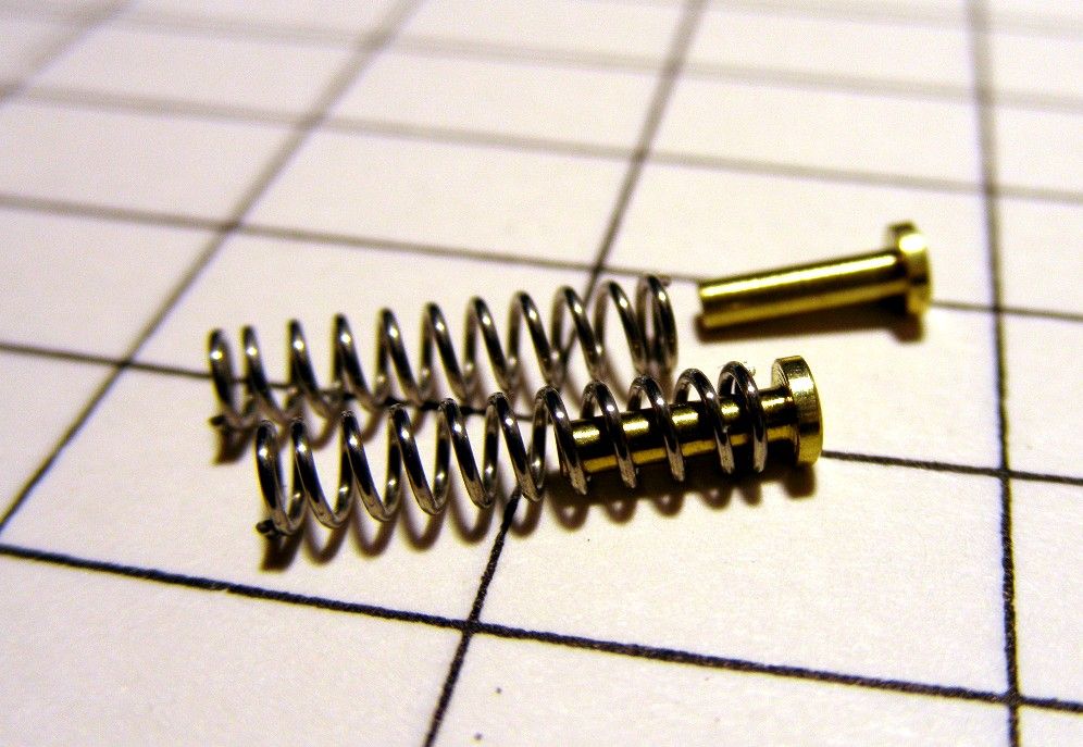

Calling all bump key specialists
Postby LockDocWa » 27 Dec 2012 21:43
These pins and springs are an invention from Ilco.
This product is known as the Ilco 1500BH ( Bump Halt )
They are designed to all but eliminate the possibility of
bypass by bump keys. Have you tried them?
Were you able to bump these open?
If so, how much time was added to your bumping success?
Not really interested in SPP statistics, Only about how they deter the bump key.

Re: Calling all bump key specialists
Postby Teddy Picker » 27 Dec 2012 23:08
atticRR wrote:is that a super spring thats designed to just mash down on the top of the driver? seems pretty valid to me. I am also interested in what people have to say about this.
It's hard to tell because of scale. I'd guess that is a stronger spring, but that's nothing new. What looks different from the pins I've seen is that extra bit on the pin. It seems like the extra thin bit of metal protruding into the spring might be there to strike against the inside of the cylinder, bouncing it back with the same kind of concussive force that bumping works on in the first place.
This would probably work best with one or two of these in a lock. That way these bounce back at different rates than the neighboring standard pin stacks. Bouncing at different rates still allows the shear lines to open (this is unavoidable without larger changes to the design) but the shear lines are not open at the same time. The greater the difference in bouncing rates, the harder it will be to bump the lock. The extra bit of metal on the pin will cause it to bounce back much faster than just a strong spring would.
Another upside to these pins is that they might be long enough to foil a comb pick. Their effectiveness against both bumping and comb picks would be increased by pairing the special driver pins with longer key pins.

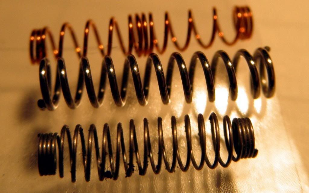

Postby LockDocWa » 28 Dec 2012 14:32
Here is a photo of a comparison in springs.
Top spring = tangle resistant.
Middle spring = Bump Halt.
Bottom spring = typical cylinder spring.
The Bump Halt is made with, easily, twice as heavy material.
LockDocWa
Posts: 251
Joined: 21 Sep 2012 9:54
