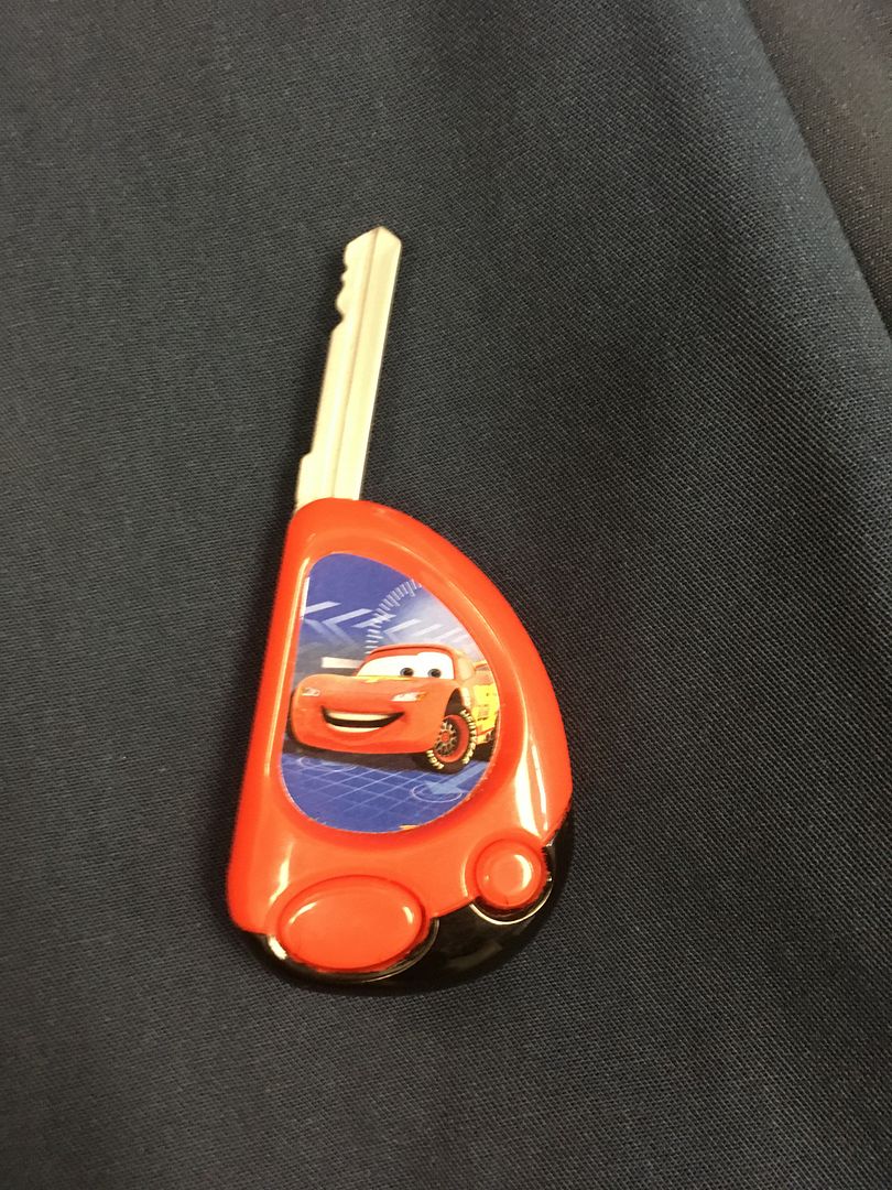

Postby GWiens2001 » 10 Apr 2017 19:05
How about identifying this key I found today?
:mrgreen:

Postby jimu57 » 10 Apr 2017 19:10
GWiens2001 wrote:How about identifying this key I found today?
:mrgreen:
Ford truck.

Postby RedE » 10 Apr 2017 19:15
:mrgreen:
Is that an automotive key? I see what appears to be buttons on the key head, indicating that it could be a remote. Yet the blade is only single cut and and aren't all non-high security car keys double cut these days? I've never done any auto work, but what you have is quite peculiar to me nonetheless.
