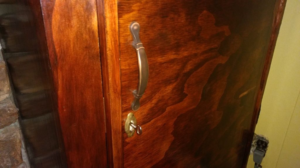

Postby theTastyCat » 25 Jun 2017 20:45
Done! Even got the strike in the right place the very first time. There's absolutely zero play and the whole thing is very solid. It's as functional as I needed and it really looks nice - this picture is sort of crap because you can see inside the crack due to the flash, but ordinarily it looks great and has brought a measure of class to the house!
And...girlfriend likes the other lock so much that I'm going to replace the bathroom door lock with it! My only concerns are that the modern knob hole is much bigger, so I may either have to put some sort of ugly plate over it and relocate the knob or just build a new door since it's as crappy a hollow-core interior door as any. Also, there's rounded trim where the strike will have to go, and seems that I may have to cut into the trim to create a flat surface to install the strike into.....the fun continues!!
