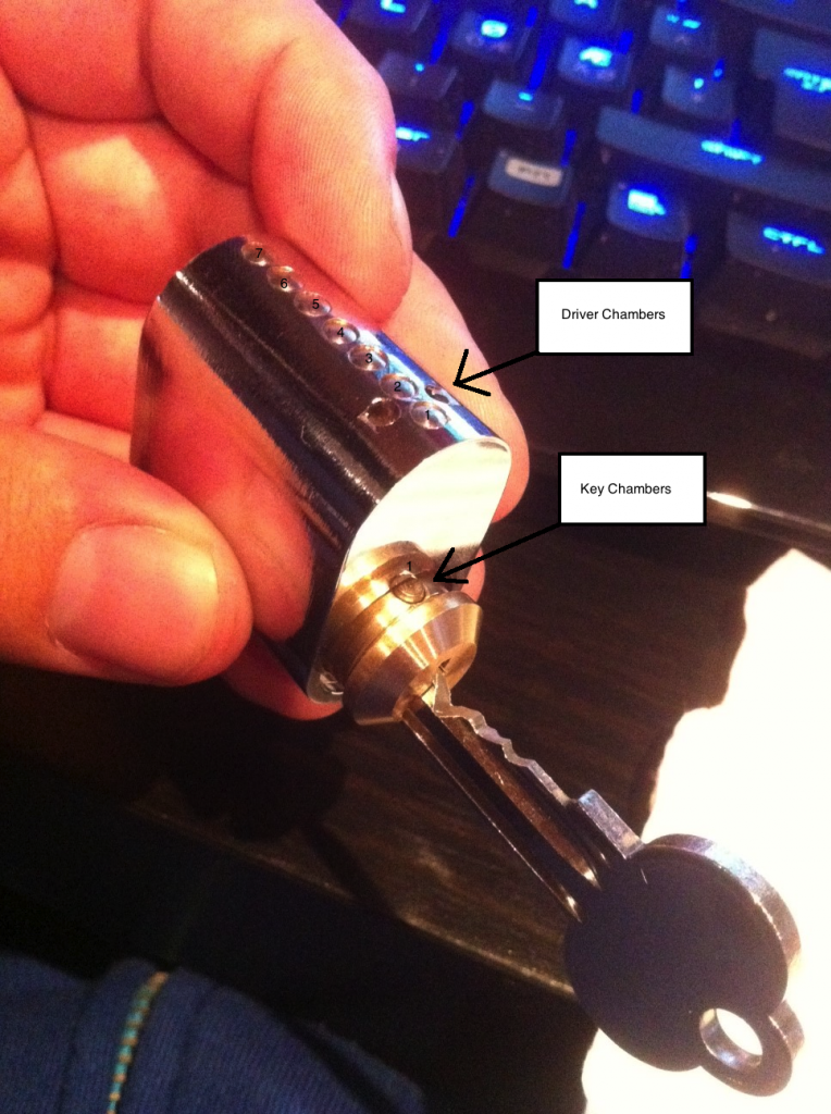

First of all i'd like to say im a beginner at this hobby.
I tried repinning a lock that i got, and everything went fine except i messed up the repinning.
Is it anyway i can get the key out?

Could you tell us how many pins were loaded in the bible and plug before this unhappy incident occurred? My guess is something like this happened:
In another post Cledry wrote:Firstly when he used the regular follower he didn't turn the plug before pushing it out with the follower. In this case he was OK doing this, but many 6 pin cylinders are keyed to 5 pin, the 6th chamber being empty. If this had been the case he would have dropped the 5th top pin into the empty 6th position in the lock, possibly locking it in place and at a minimum destroying a spring. So always turn the plug before inserting the follower.
If you can manufacture something like a comb pick, you could work the contents in the plug (other than the key pins) back up into the lock. If you don't have a set of comb picks, you can manufacture one from a strong wire bent in an L-shape with the shorter part of the "L" being as long as possible while still fitting in the lock (hope this makes sense, pictures can be provided if needed). If you have more than one driver chamber emptying into a vacant key chamber, this can be very difficult without a comb pick that will lift all of the chamber contents at once.
Heres a modification of your picture to help you understand my sometimes incorrect terminology:

Hit the cylinder against a hard surface such as a vice or concrete steps or metal stair rail, while at the same time trying to pull the plug out of the lock one step at a time. Timing will be critical.
Keep hitting the cylinder in sharp quick blows, in order to bounce the pin stacks and create a shearline. I believe some would call this rapping, and it is where the idea for bumping came from years ago.
You may also use a wooden mallet to strike the lock body from the bottom or top to see if it gives better results than hitting the lock against other surfaces.
I think you will have to pull the plug and key OUT and not push it IN because the 7th chamber spring has already pushed the driver pin down, but it is worth a shot to maybe try to hit the lock and push the key and plug in. This may crush a spring, so it's up to you to try it.

Five of the seven pins are locked up. The key has most likely pushed some bottom pin above the shear line so picking from the back is probably out of the question even if you could access the back. If rapping on wood does not work, it is time to drill out the caps of spaces 2 through 6. Dump the pins and turn the plug before pulling it out again.

Got my key out guys!

I was watching The Walking Dead while having the lock+key in my hands. I had my smallest hook in from the back and was kinda
fooling around with it. It turned out to be only 1 pin that held the key in, so guess i managed to pick the pin back up. Dident realize it before i suddenly took my key out!
