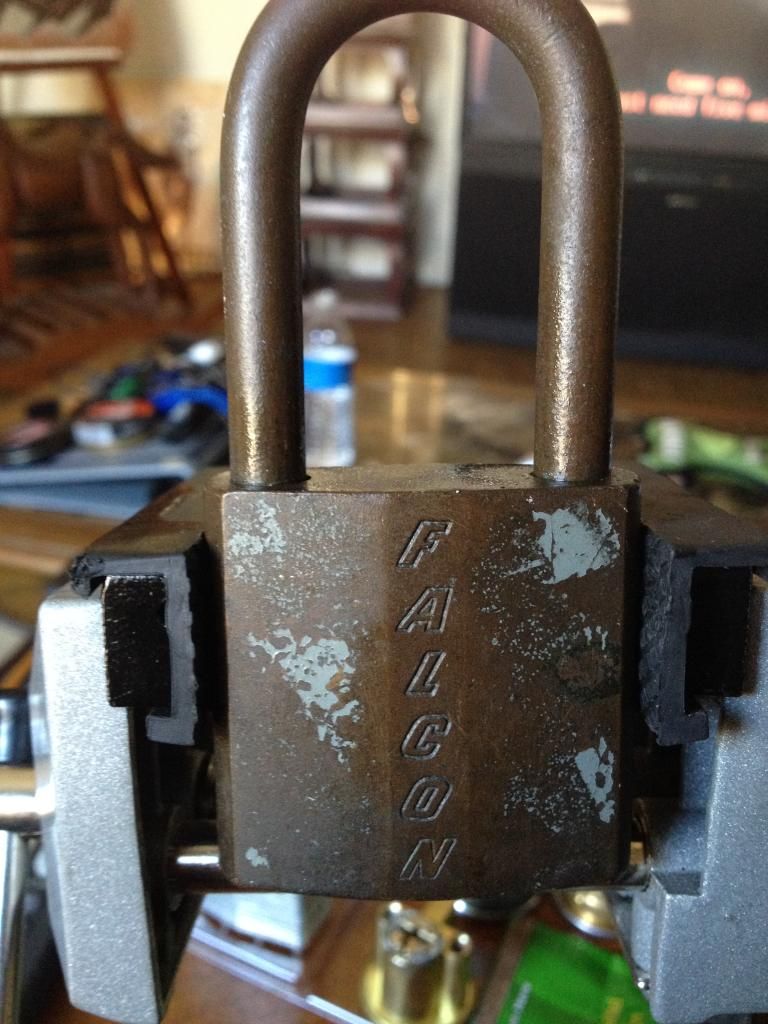

I was sitting in my mother's living room when I rememembered that about 30, or 45, years ago I somehow managed to wander home with what may have been a school padlock that someone may have left unlocked.
On a whim, I walked out to the garage, and low and behold, there was what may have been a school district Falcon padlock sitting on one of the studs that made up the garage's unfinished interior wall. If I had to guess, I'd say that the lock is at least forty to fifty years old. After all, it couldn't have been new when I found it.
The lock was unlocked. I sprayed it liberally with WD40' took it home, and went to work. So far the lock is kicking my ass.

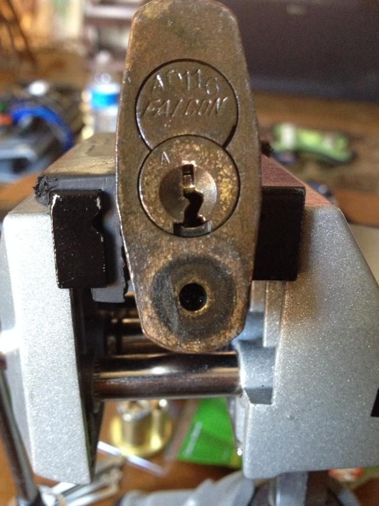

Very light tension and it will rake open in seconds.
Posts: 7680
Re: Falcon Padlock Blues
Postby cheerIO » 23 Aug 2014 18:38
Also, make sure that you are getting all the way back in the plug.
There are six or seven pins in there.

Postby Hachronn » 23 Aug 2014 19:55
cheerIO wrote:Also, make sure that you are getting all the way back in the plug.
You called it. Much to my embarrassment, it looks like I kept missing pin seven. :oops:

Postby jeffmoss26 » 24 Aug 2014 12:06
Different style lock - the OP's is a SFIC.

Postby Hachronn » 24 Aug 2014 13:30
I'm working on getting it to control, but so far I'm not having any luck. Any tips?
Hachronn
Posts: 135
Joined: 7 May 2013 14:22
Location: Southern California
Postby averagejoe » 24 Aug 2014 13:39
Here is a great site on the basics of SFIC if you have never encountered them before http://www.crypto.com/photos/misc/sfic/
averagejoe
Posts: 490
Joined: 17 Jul 2011 6:12
Location: Canada
Postby Hachronn » 24 Aug 2014 14:04
averagejoe wrote:Here is a great site on the basics of SFIC if you have never encountered them before http://www.crypto.com/photos/misc/sfic/
Thanks Joe. I'd seen Peterson's I-Core tools, but I missed their actual purpose until I saw them explained on that site. So unless I manipulate the control sleeve I'm really just playing a count the bind (And pray I don't over lift) guessing game.
