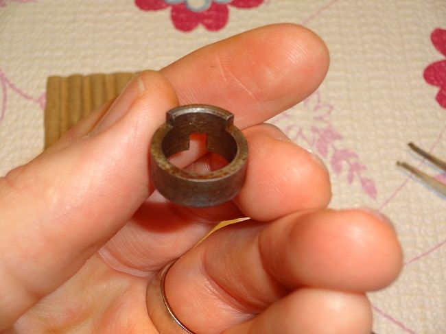

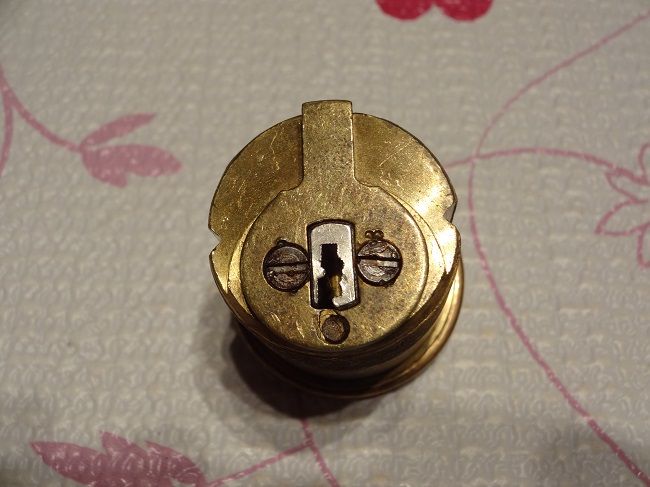

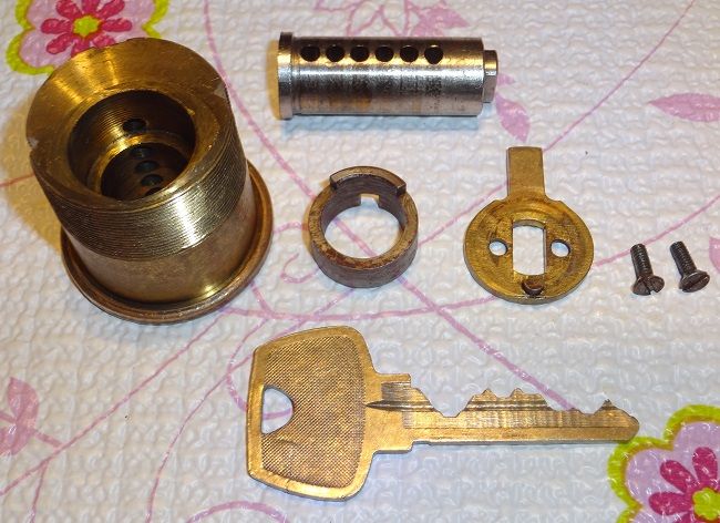

I found some of these old Sargent cylinders at a scrap metal dealer last year. Once I gutted them I discovered an extra ring around the rear of the plug, something akin to a truncated version of a master ring but only allowing different pinning on pin 6.
It turns out this ring piece provides the 'hotel function' found on many hotel room doors (non electric with standard keys). It's a simple yet elegant solution.

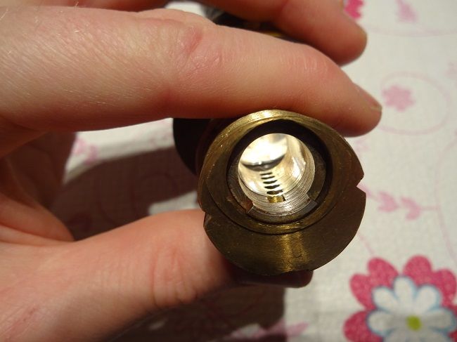

The ring piece accomplishes this by limiting the travel of the plug for guest/maid keys so only the latchbolt is engaged. Emergency keys can turn the plug all the way around, thus engaging the deadbolt.
Here's some pictures:

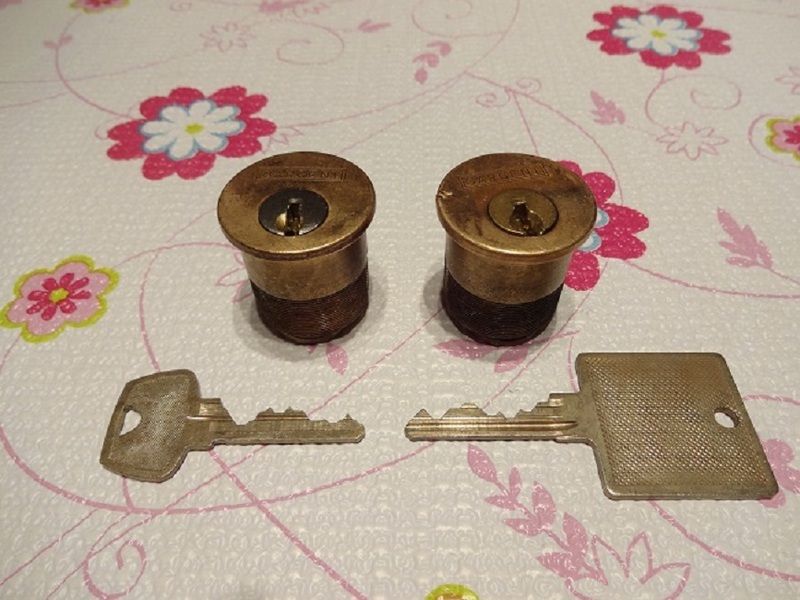

Sargent Mortise Cylinders x2 - Each with own key - KD

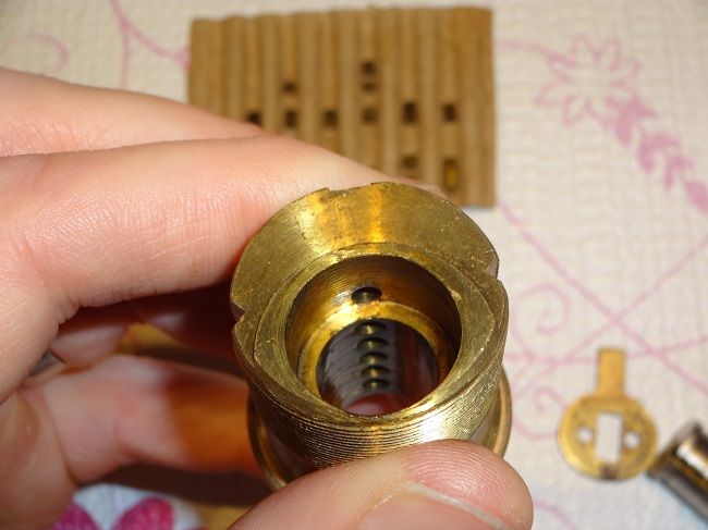

Rear of cylinder and tailpiece.
Tailpiece removed - ring piece now visible surrounding plug.

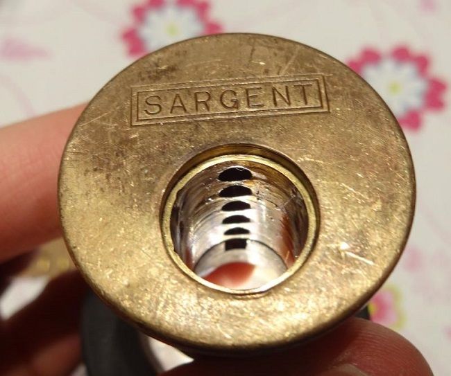

Front view with ring piece in-place. See 5 round pin chambers and 1 square slot in ring piece for 6th pin.

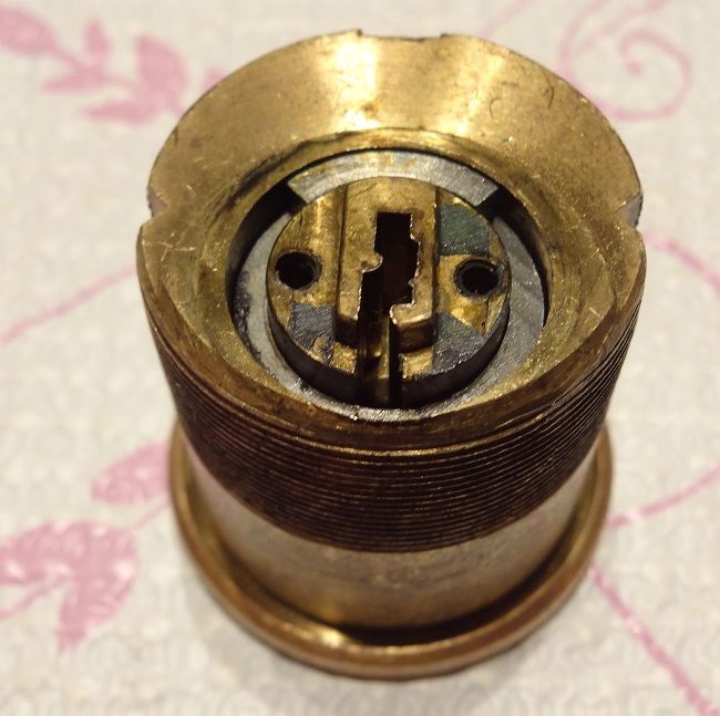

View inside the cylinder from back with plug removed. Ring piece still in-place.
Ring piece
Rear of cylinder - ring piece removed.
Dissassembled. Gotta love the bittings you can find on Sargent :)
Pins - master pins found on all except chamber 6.

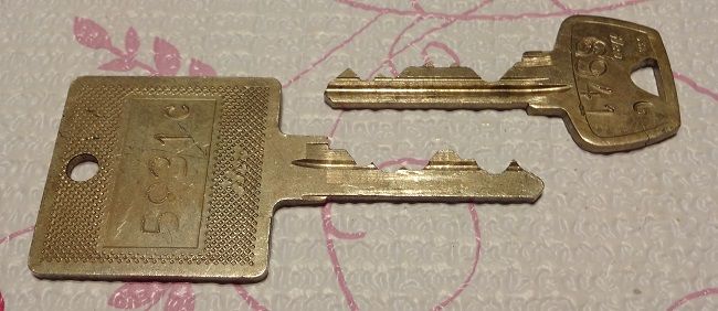

Keys x2 - each KD.
