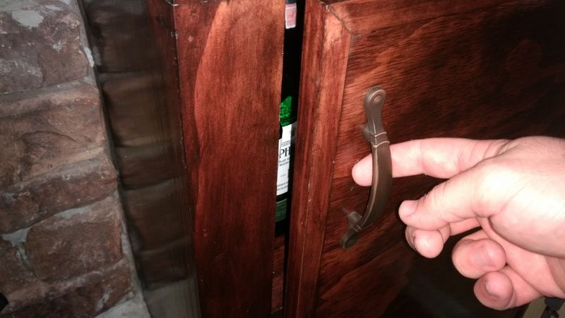

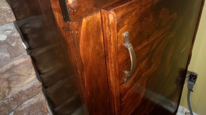

Hey all - long story short, I built a wall of cabinets and would like to add a lock to one. I recently returned from a trip to Scotland and was struck by the elegance and functionality of some very old locks which were still in service and still doing well, many requiring skeleton-ish keys. I'd like something like that for this lock and have found several similar ones on Ebay.
However, check out the cabinet door in question; since I didn't build it with a lock in mind, it's not really ideally suited for one. Might it be possible to mount one of these grand old locks on the inside of the door and put some kind of plate on the opposing jamb, then create a hollow for a bolt? I've seen several that also come with a front plate that could hide the hole I'd need to drill for the key.

Postby billdeserthills » 6 Jun 2017 0:15
I'd like to say "yes" but I don't know what this 'grand old lock' looks like, without a photo
If you mean the 'Rim lock' that was designed to be mounted as you wish, inside the door
with a keyhole drilled through the door, and an escutecheon plate over the keyhole.
I can see using a mortise lock case, I don't think you need to build a box for it to sit in,
so much as perhaps a frame for each corner. The lock can be mounted 5/8" away from the
edge, and you could just add a strike, I like to use an "L" shaped piece of steel,( I usually get
mine from the 'charlie bars' as a left-over)--That would save having to making a hole in the side of the cabinet
You don't even need the 'L' shaped steel, a couple of wood screws will keep the door shut
Edit to say:
(On many cabinets the hinge screws can easily be removed, which negates the locking effect)

Postby Jacob Morgan » 6 Jun 2017 11:03
The eBay link looks like it is going to a mortise lock. As Bill indicated, a rim lock (may be called a surface mount lock also) would be more appropriate. A mortise lock goes into a hollowed out space in the door while a rim lock is mounted on the inside face of the door.

Re: So...how to add an *old* lock to a new cabinet door?
Postby ratlock » 7 Jun 2017 1:09
It is possible. If you added extra timber to the inside of the door for the lock to be morticed into, and extra timber onto the jamb side for the keeper.
However, this would take up so much extra space in your drink cabinet, you would have little or no space for your drinks.

I don't suppose you really need to mount your lock with a 5/8" gap, you can just mount it on the edge
of the door. You'll need to make a frame to hold the lock in position, or use some shim stock to mount
it so it is held firmly in place-
The rim lock would be easier, as it is already flat on the side that sits next to the door
