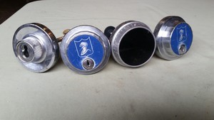

a photo or two will really help us give you the right answer, could you upload a photo to http://tinypic.com or http://imgur.com and Paste the link in your reply?
If the change key hole is a circle with a flat bottom, then it's a LaGard 3330 lock, I have seen their part/serial numbers start with B.
Also, are you pretty familiar with the procedure in order to change the combination? Have you dialed the current combination to the change index located at about 11 o'clock on the dial ring and then tried to insert the change key into the back of the safe lock body?

Yes, the dial looks like the second from the right with the helmet.
I do know how to change the code on a SandG. The SandG key I have won't fit this lock. Its too big.

I meant 2nd one from the left and the one on the far right with the helmets.
I did a search. Is it the 1307 change key that I need? And I do it the same as on a SandG lock?

We actually need a photo of the change key hole to help verify it, or just the whole back plate that the change key hole is on, not of that sticker. The sticker doesn't help much actually.
Yes, the Lagard locks are good and procedure is the same as most modern safe locks and you can google for the factory instruction sheet as well. Here's what Dr.Google found for me: http://www.mbausa.com/Files/LAGARD%203% ... anging.pdf
Lagard 3 wheel change keys are available on ebay for +/- $10 dollars. Here is one for $4.99 with free shipping http://www.ebay.com/itm/231529388744
