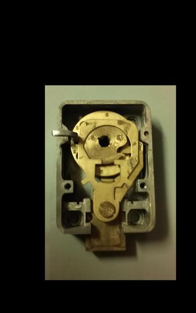

Squelchtone,
Mustache shaped flat brass plate? Can't say that I've seen that laying around in one of my ziplocks.
When you get the lock, dial, dial ring, please take a look at the spindle and see if you think it has a slight bend to it (or is not pressed in straight). I was seeing a 1/8" "kilter" in the spindle when I rotated the dial while the lock, dial ring, and dial were reassembled.

djed wrote:Squelchtone,
it was used way back in the day before they invented the change index method. it was a lever arm that the change key would tilt up which kept the lever arm and fence floating over the wheel pack so it wouldnt fall into the gates being aligned at 12 oclock as one changed the combination. The change key while inserted into the lock would still go into the wheels and unlock them, and the flag on the change key would flip the mustache lever as well.

Postby femurat » 8 Mar 2016 3:53
I'm happy when I learn something new. Thanks for the picture and explanation. Even if, summarizing what billdeserthills said, this thread is "useless" from a locksmith point of view, at least was useful to teach me about this old feature.

Postby GWiens2001 » 8 Mar 2016 15:59
I learned something new as well. Had to blow up that pic to see that the lever actually has a hole in it that the change key fits into. Pretty interesting. :)

Postby Raymond » 8 Mar 2016 20:15
Here is a photo of a very similar lock showing the lever lifting plate. The change key inserted is leaning because the back cover is not present to hold it straight. When the key is turned, the lever is lifted clear of the drive wheel.

Postby Squelchtone » 9 Mar 2016 2:02
Raymond wrote:Image
Raymond wins the prize, I think he's right, and as I have said before, I learn something new here every day!
averagejoe was quick to notice the change key hole location in the 3rd video was not in the normal location on the back cover!
I have to agree that the plate is missing and the change combination would have gone smoothly for the djed if the plate was there keeping the fence from falling into the gates.
Here's a page from a 1989 S&G catalog showing that part, along with the option for a 0 change back cover.
That pic is from this file http://wheelpost.com/Documents_PDF/SG_parts_catalog_1989.pdf hosted at the http://wheelpost.com which is something Brian Costley, retired Sargent & Greenleaf Training manager maintains.
I wonder how/when in the life of that safe that plate was removed, and if it was done by a safeman/locksmith so customers wouldn't get themselves in trouble trying to change their own combination, or what...
