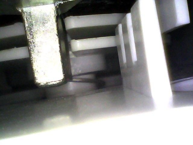

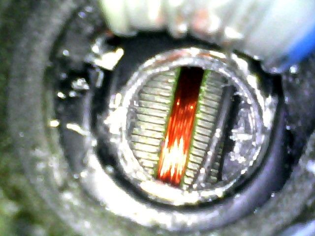

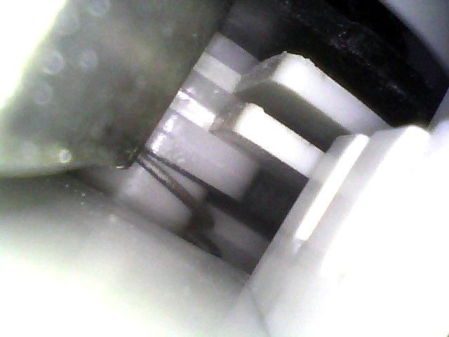

Postby LockDocWa » 22 Aug 2013 21:20
Here are some photos using a CHEAP endoscope.
