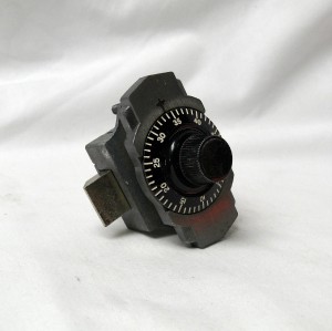

I'm pretty certain that the type of S&G safe lock you have is more like this format:
Yale and S&G made similar stuff, some of them looked like this inside:
Fig 2. Example of what yours probably looks like inside.
They don't make them any more and god knows i cant find a Google images search result that shows what it actually looks like from behind, but basically it works like a big boy safe lock, just looks different.

I think you have a 6720 Lock , which is a normal footprint. I've scaled the photo to a similar dial ring then placed the lock behind it and checked these pictures, and it looks like a regular lock may fit. with the bolt of the lock holding the door in place.

Also Squelch, that lock you posted. the small one you said you couldn't find any pics of the back.
I have one now. and would be more than happy to take some pics for you.
