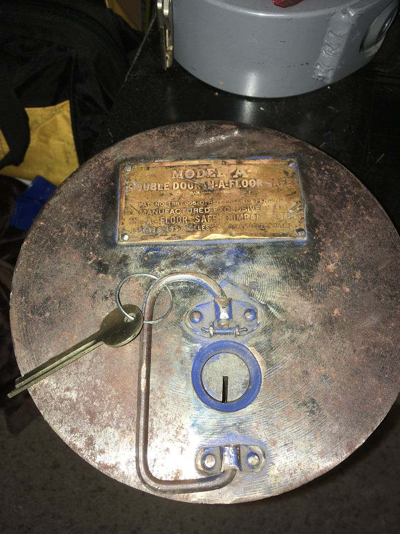

Hello everyone. I have found a round floor safe in our 1953 Salem Oregon home embedded into the garage concrete floor and was painted over and hidden until recently.
This door has a name plate as follows:
MODEL-A-
DOUBLE DOOR IN-A-FLOOR
PAT NO 1-887866-1,919.64 (as best I can make out)
MANUFACTURED EXCLUSIVELY BY IN A FLOOR SAFE COMPANY
195759 S.LOS ANGELES ST., LOS ANGELES CALIF
I need a key. I found a previous post by 68merc 9 Mar 2013 with attached picture of round door that looks just like mine. I have printed the conversations and recommended types of keys to fit the S&G 4161 or S&G 4163 and have shared these with local lock-smiths and been told that they cannot help. I've looked for a safe-tech but with no success.
What's my next step? And thank thanks in Advance

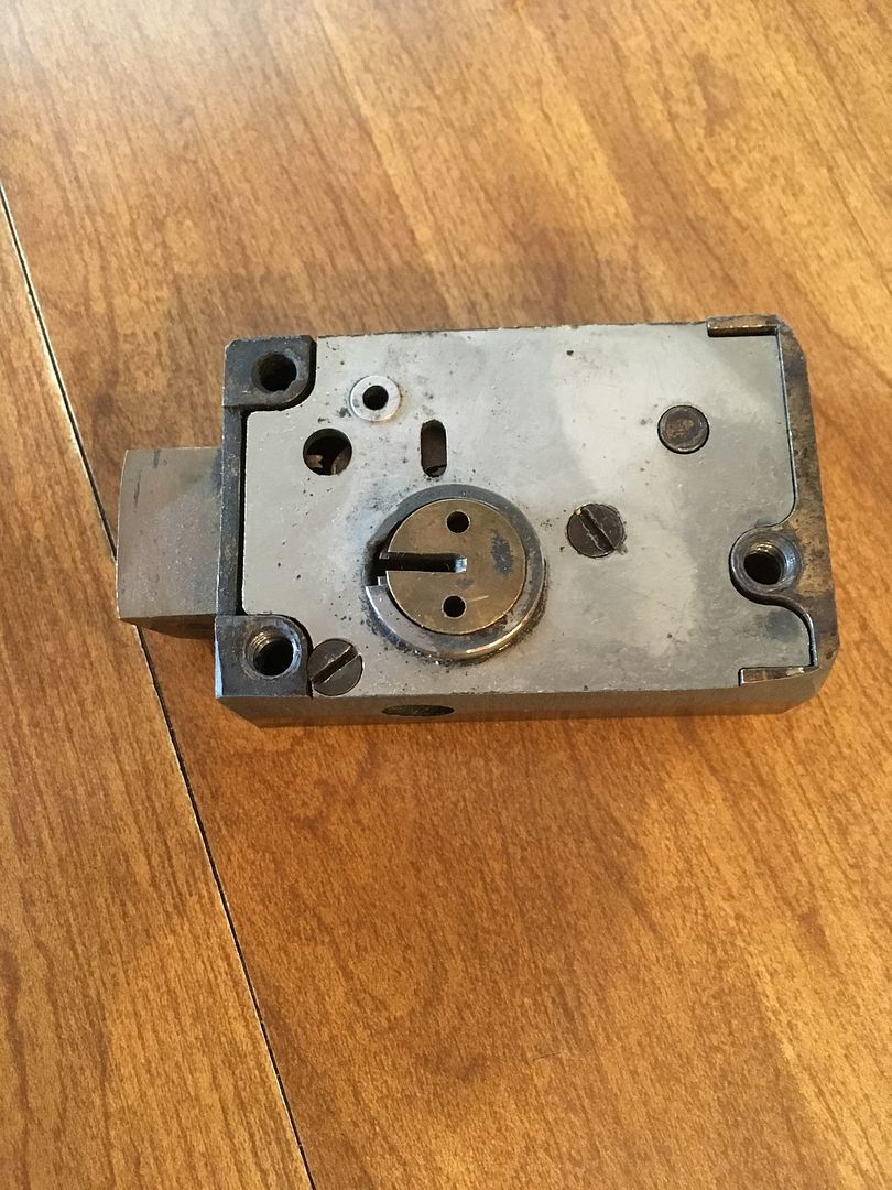

Have one of those Double Door In-A-Floor safe doors in my collection. It looks like this:
The standard lock used in those safes is a Sargent and Greenleaf 4160 Series safe deposit lock. Which model used depends on when it was made. The 4160 series was first made in 1945, and AFAIK it is still being produced.
If the door is older than 1945, it may have a different lock. It may also have been repaired or replaced and have a newer or different lock. But this is where I'd start.
Keep in mind that this safe door does have two relockers which are fired if the lock is punched. Will not give pictures or more information about the lock or relockers on the open forum.
Squelchtone is correct that your best bet is to get a decent safe tech to open the lock for you. If the tech needs to do destructive entry (ruin the lock itself), at least he/she will know what kind of replacement lock to bring along.

Postby charliechanhockchye » 20 Aug 2018 12:13
Gosh thanks folks! Gwiens2001 posted a picture of a safe that looks just like mine and Squelchtone I will make contact with those safetechs and will keep you posted as to the outcome. I also have a link to a picture of the safe in my floor. Talk later and thank you again.
https://charliechanhockchye.imgur.com/all/
