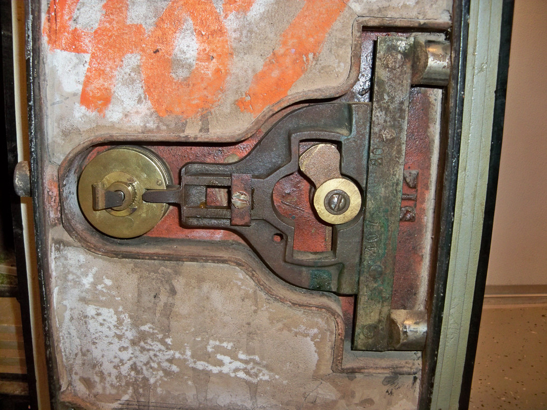

It looks like it may be a generic small safe of the times branded by Joplin safe. I have a couple small ones with Yale locks and on one you have to do this; dial as you are but after 20, turn left to 0 and try the handle. I don't have a picture of the lock on file.
If it has this style Yale used on some small safes, then you need may need to dial to a 4th number. So the same as above but after 20 stop on every number going left trying the handle on each one. This one has the drive wheel notch at 28. I assume they made assorted drive wheels with different numbers?
That's all I got other than I would be shocked to find a friction fence in one of these small safes.

00247, I think you're right, after spending the week thinking about it, I recall that when I was a kid we had taken the back panel off of the safe door when it was unlocked one time, and it looked very similar to what your picture showed. Two bolts extended outward into the door frame and there was that odd mechanical shaped item where the lever/handle was attached to.
