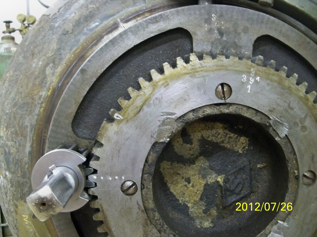

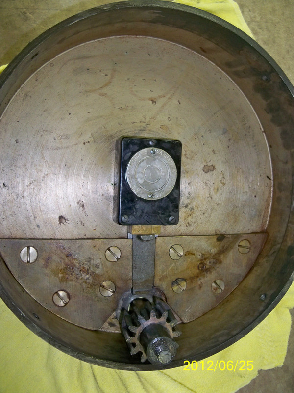

If you cannot get the combination to work the door cover can be removed to gain access to the lock or look for other problems. If the door rotates, screw it into the body close to the fully closed position. It probably won't close all the way until the mating surfaces are cleaned and polished. Then remove the lock screws on the door pivot bolts, back off the door pivot bolts to clear the cover and swing the door cradle away, remove the 4 bolts that secure the door cover and remove the cover. It's heavy and may have to be jiggled to get it off, don't drop it. Watch the small pinion gear that the crank goes on so it doesn't fall out. You then can access the lock. Here is the inside of the door.

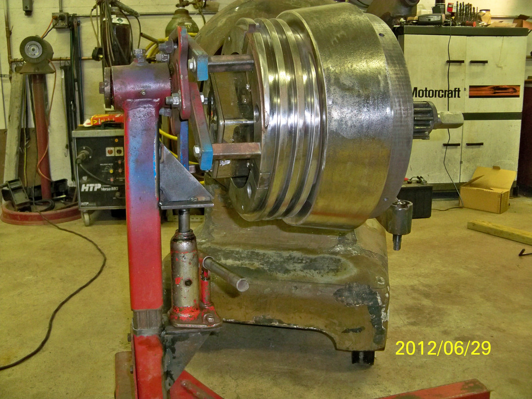

If your door will not rotate you have a bigger challenge. You will have to rig the door somehow to hold it securely so that the cradle can be removed to allow the door cover removal. Be careful, the door is very heavy. I modified an engine stand to support the door when I had no option but to remove the door from a Victor cannonball.

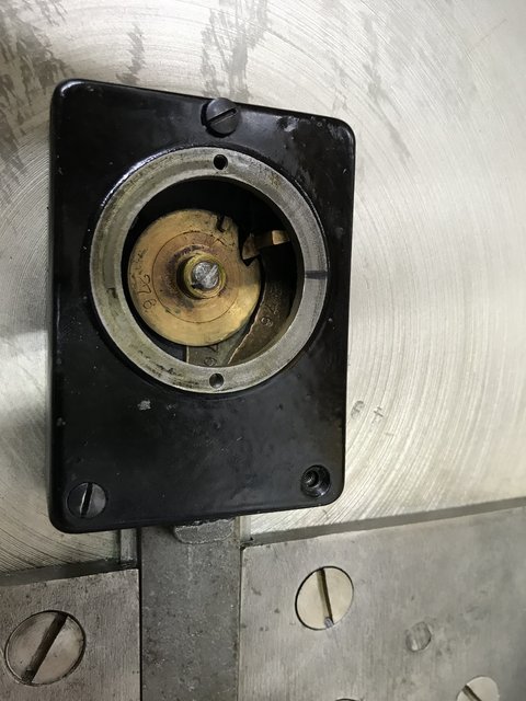

Postby Trex123004 » 27 Jan 2022 7:05
I've got the cover off the safe door just like the picture below. but im not certain on how to figure out the combination when I get the cover off. Any help would be appreciated.

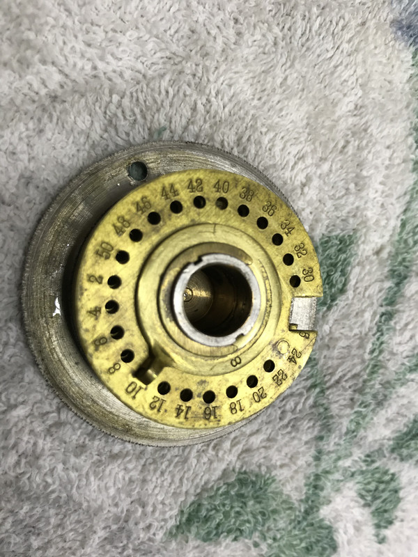

It should be a variation of the S&G lock I previously posted. Remove the two small screws that hold the round shiny wheel pack. I forget if you have to twist this model slightly. Wiggle it and the wheel pack assembly will come out.
As you can see, once the wheel pack is disassembled you will know the combination. Disassembly is straight forward, but make sure you methodically place the parts in order of removal to not mix anything up. Take pictures or make notes of each step depending on your mechanical abilities. Clean all parts thoroughly. I would assemble it dry as it is all brass.
You can note the combination number on each wheel and use it or change the number on each wheel to what you want. Remove the cover of the lock to clean all parts and make sure the fence spring is intact. I would also pull the spline key and remove the drive wheel and spindle for cleaning and lubrication. Your lock could be slightly different inside than this one. It is possible that the lock will use a change key. Later Victor cannonballs did, so post some pictures of your lock and internals. Also post a picture of the door threads. That will help date the safe.

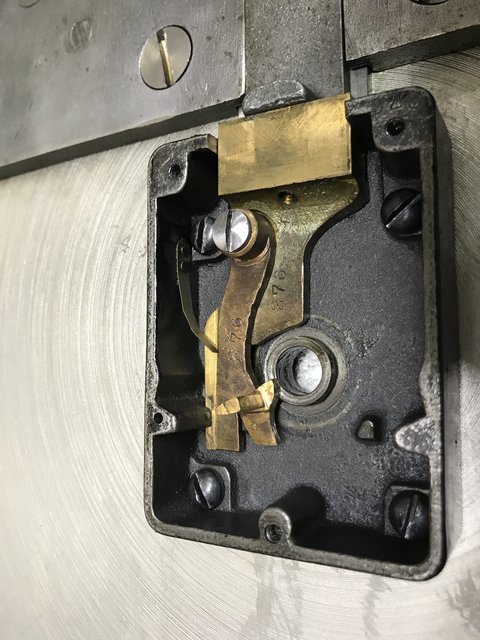

Postby Trex123004 » 28 Jan 2022 10:25
Mine only has 1 screw and it looks nothing like that.
