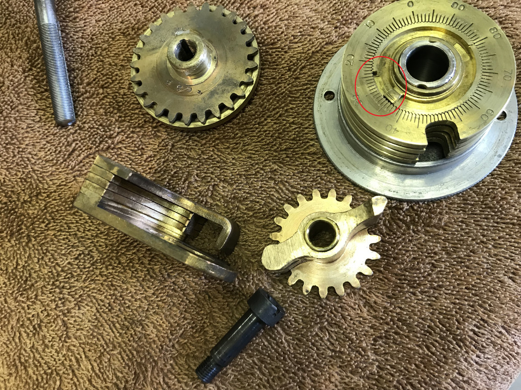

Postby 00247 » 10 Jan 2022 21:27
First I will rub salt in your wound and remind all newbies to never participate in the cardinal sin of closing the door and locking a safe until you are sure the lock is working satisfactory, preferably serviced, and that you are are confident with the dialing procedure. Lock the door with the door open and practice.
Squelchy and Martin have given you good advise. I will add a picture of the lock internal parts with the fly that each wheel has circled. It is able to slide back and forth in that slot to compensate for rotational direction. They are generally reliable in this style lock but never say never, there could be an issue. The fact that the dial feels differently when turning clockwise tells me the friction fence is operating and being forced into the wheel pack/drive wheel. If these locks have a lot of use the drive wheel could have wear which will give the feeling you describe. The friction fence usually won't cause a problem especially this style that has the internal spring sealed in with crimps on each end.
Dialing a little more forceful could move a sticking fly. Watch the video with just the drive wheel and notice how much movement there is (estimate how many numbers) from when the drive wheel gate allows the friction fence to turn in to where the dial stops. If your had dial stopped at 91 the time it opened then back up that distance plus a little more and work it back and forth and hope the wheels jiggle a little and the fence turns in. The suggestion of dialing with one number high then low and trying all of them one at a time is a good one.
These are pretty good locks, there could be an internal issue but first I would eliminate possible operator error.
