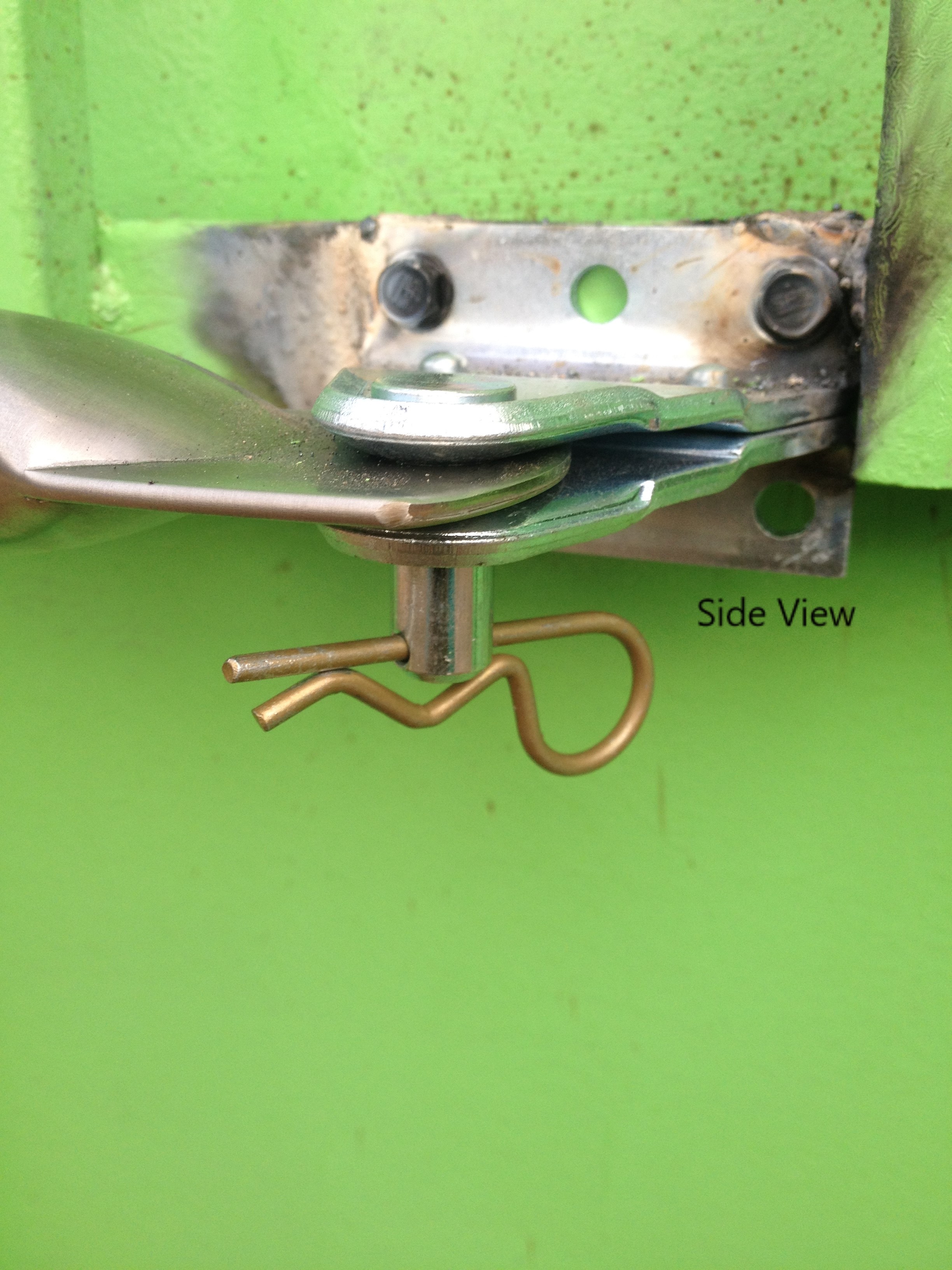

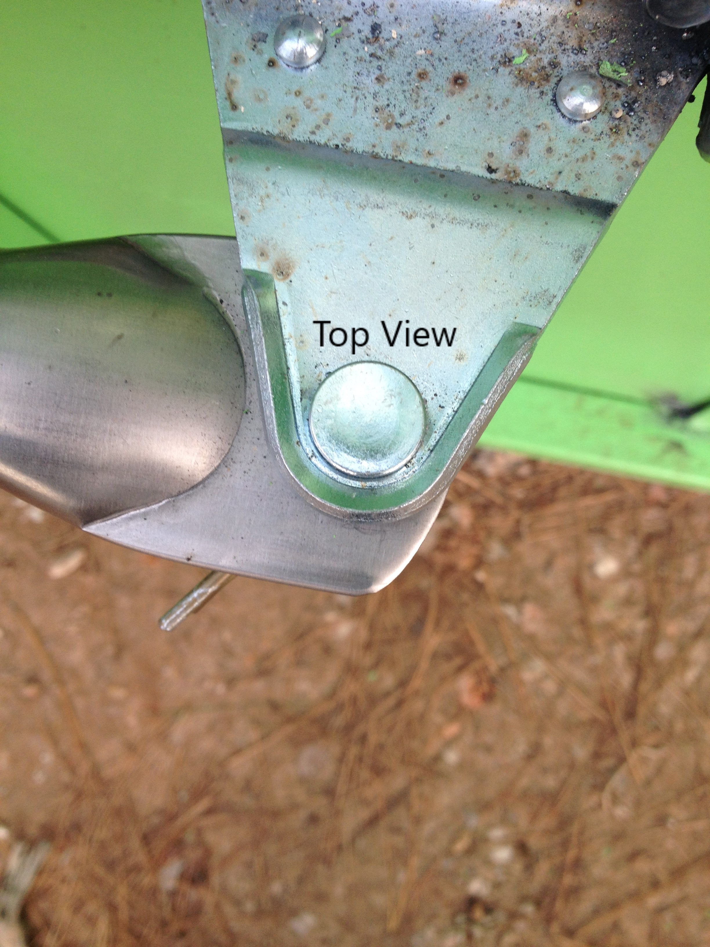

The gate hardware is largely installed, we opted for a Liftmaster LA 400 system with one arm on each leaf/gate, i.e. the vehicle gate has 2 leafs, each with one liftmaster arm.
It seems that the liftmaster arm can be disconnected simply by removing this hitch pin and removing the bolt - images for viewing below.
I was informed by the installer that a better option would be to either
a) Replace the bolt and hitch pin with a 1/2 inch hitch lock
b) weld the piece connected to the plate so remove the bolt and hitch pin all together and weld the plate to the clasps, of course this would mean it would require grinding down the weld if the arm needs to be changed
My question to you is whether there are some good quality hitch locks that you recommend? Or alternatively some other mechanism to secure the arm.
Thank you

I always thought maybe a collar and a Padlock, The Pin being larger than most padlocks?

Postby globallockytoo » 3 Jan 2018 14:45
You might consider a Meroni Luccotto padlock.
http://www.ufomeroni.com/luccotto/
site shows rubber ends but they are also make stainless steel
