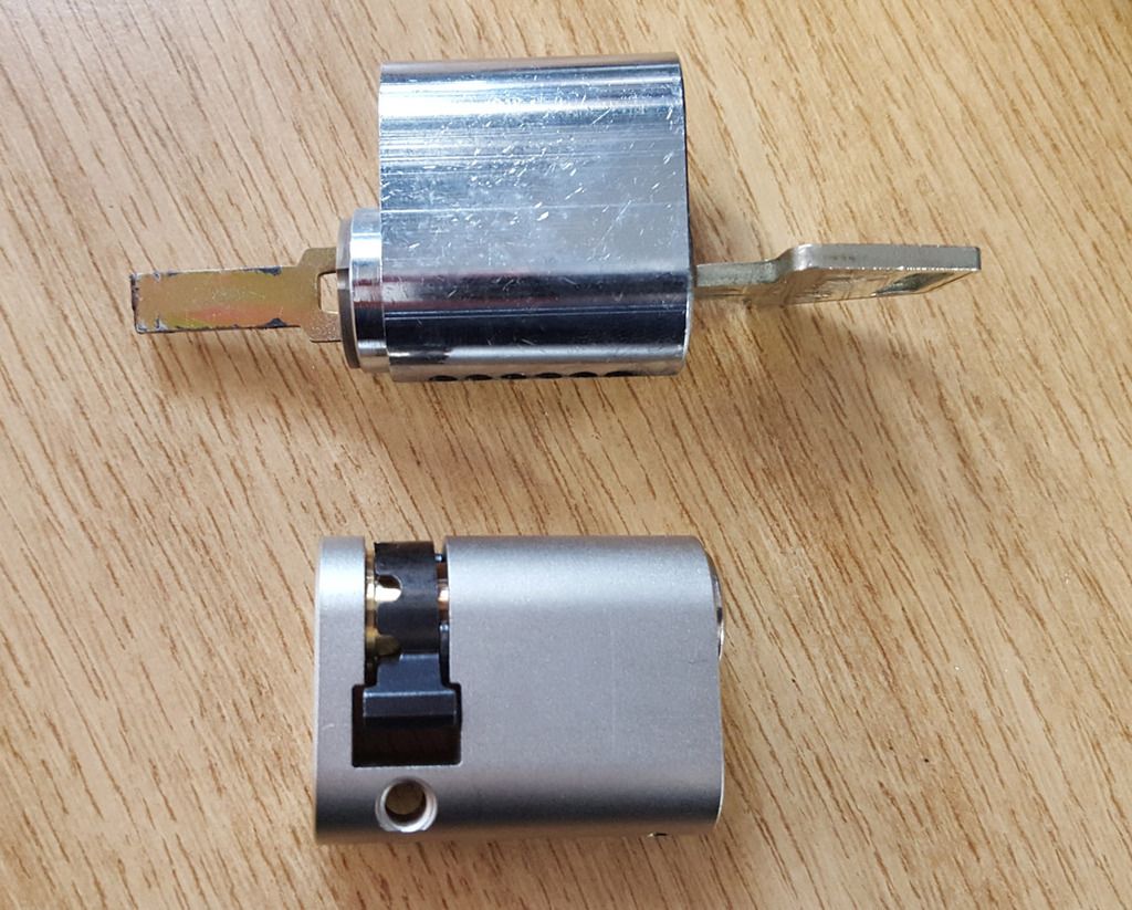

I've hit a small snag, which I'm hoping someone can help with. No big deal if not, for reasons I'll explain :).
So, it turned out that three full Euro cylinders and two half Ovals were needed. The full Euros were for outer doors, and the half Ovals go on the inside of two other outer doors, however the lock does not protrude from the outside and can only be accessed from the inside. On that basis, replacement locks weren't "really" needed but for a complete, keyed-alike solution we decided to replace all locks. The Euros came through fine, however unfortunately they sent half-Euros rather than half-Ovals so they had to go back.
The half ovals finally came through today and despite fitting the keyed alike profile and being technically correct, it turns out that the actuators on the ones in the door are totally different from the ones that arrived. Unfortunately they're non-returnable except in cases of "DOA" product and incorrect spec on their end (such as sending the half euros), so I'm "stuck" with these (new picking project? Haha). However the closest thing that I've seen to the existing locks is the rear of my Ruko cylinders, which makes sense since these are Ruko branded also. However they also have a long stick coming out of the actuator, similar to a mortice door latch.
Just wondering if anyone can identify the old Ruko lock cylinder type? It appears that it's just just a regular straight half oval. I very much doubt that I can get a new Kaba in that old lock's form factor (and it doesn't really matter much anyway, since at this point they're really more being used as thumbturns anyway), but it would be interesting to know what's up with these older locks and if there's a way to get a new Kaba pExtra Guard in that form factor.

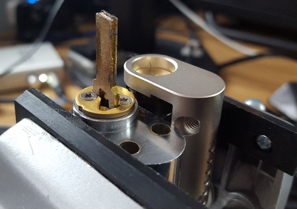

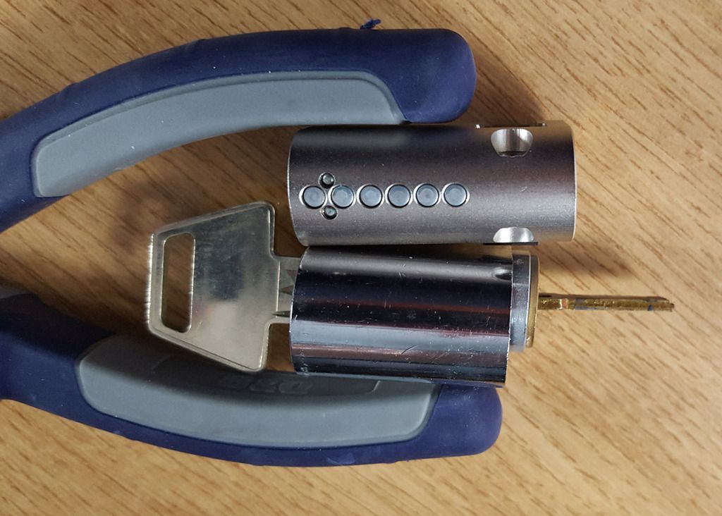

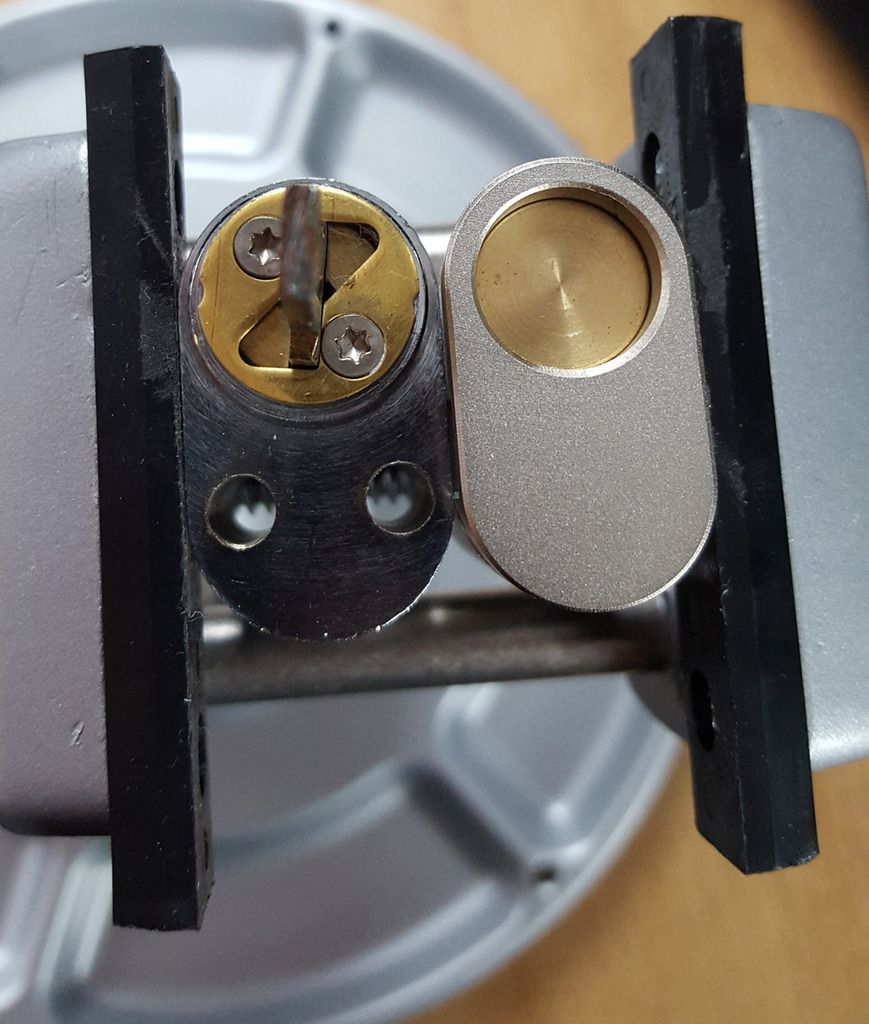

Here's some pics:
Cylinders side by side - old one on top, new at the bottom:
Showing the size difference:
The backs of both - old on the left, new on the right. Note that the old style one cuts off just after the end of the cylinder, and the back of the plug is attached directly to that Z shaped actuator plate (similar to Ruko padlocks), from which the long actuator stick protrudes, whereas the new lock has a regular Euro style cam, and then a bit more metal at the back to hold it in place. Also, the old style locks attaches to the door with two screws screwed in directly from the front (you can see the two screw holes), whereas the new one takes a screw from the side in the same way as a regular full Euro:
You can see the side screw here:
The fronts of both locks - old Ruko on the left, new on the right:
Thanks for any insights :). It's not vital that these be replaced but it's interesting that they seem to use a totally different type of cam; one that I've not seen in any of my other research for trying to find a half Euro.

Postby ARF-GEF » 20 Feb 2016 15:43
Weir,d it's not just the cam, the size is also different as is the method of fixing it.
I always thought the scandianvians are standardised as well, and that the ones with 2 holes going all the way through are going on the inside the others on the outside.
