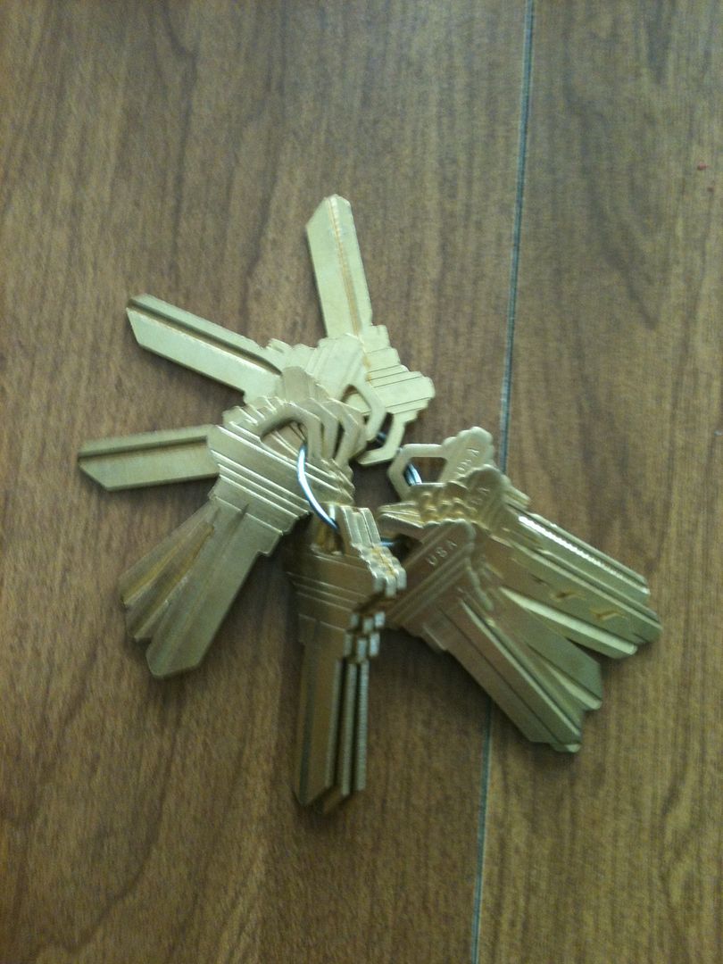

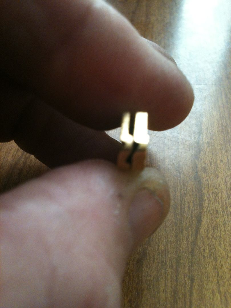

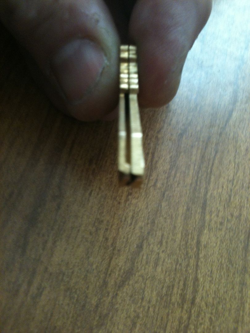

ARF-GEF wrote:AAand I just got like 20 faulty(!) blanks from them... It wasn't jsut a different profile, the keys were too thick...
Have some Schlage SC1 blanks (15 of them) on which the wards are not milled deep enough - they won't fit into the lock, either. Was not paying attention when I cut one and could not believe that I had misidentified a Schlage C keyway. Turns out I didn't.
Don't know how I missed that when grabbing one to put into my key machine! :oops:
