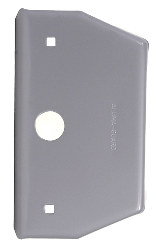

Kawneer pivots are a possible security risk, replace with Roton hinge. Put a latch protector that interlocks and also covers the cylinder in front door Major Manufacturing Aluma Guard . Lock cylinder you have is junk, replace that.
Steel door is fine as is glass but add 3M film. Check hinges, they probably already are NRP hinges. Install latch guard with interlocking pins I prefer Trimco. Deadbolt is a bit weak, bolt is vulnerable, consider one with an anti probe guard built into the outside housing.

I would also put an anti-wrench collar around the aluminum-glass door cylinder, in addition to the other suggestions. Is there adequate lighting at night?

dll932 wrote:I would also put an anti-wrench collar around the aluminum-glass door cylinder, in addition to the other suggestions. Is there adequate lighting at night?
You don't need it and it won't work with the latch protector from Major Manufacturing that I mentioned. The hole is smaller than the cylinder which sits underneath the plate. It allows the key to pass through. On the frame also under the plate is another piece that prevents spreading of the frame. It is easier to understand if you look at the installation sheet.
http://www.majormfg.com/instructions/download.aspx?part=ALUMA+GUARD
