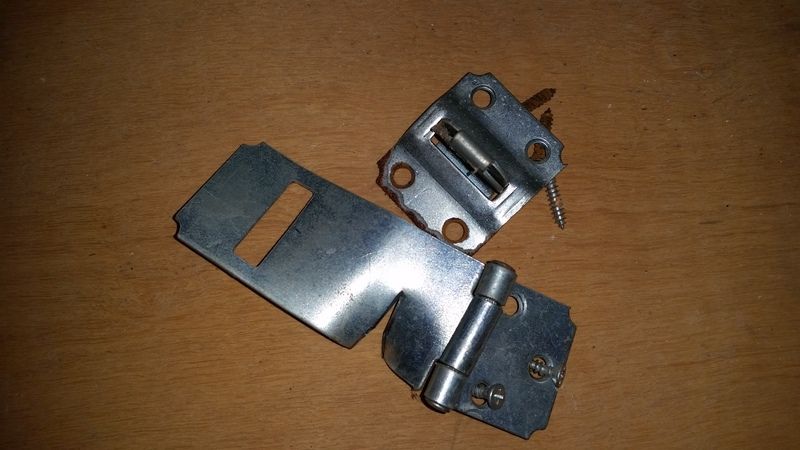

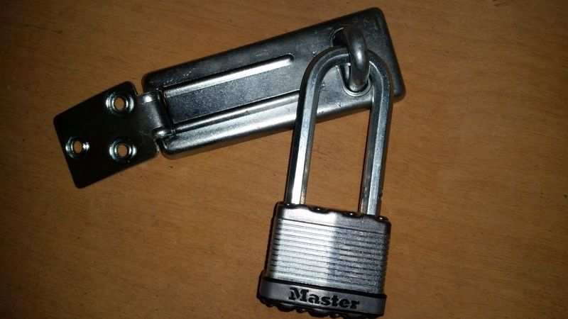

Postby Number21 » 8 Nov 2016 3:40
I will look into the SFIC locks. I think I'm going to have to settle for at least 2 or 3 different key styles.
Here you can see the carnage from previous break ins, in every situation a more expensive lock would not have stopped them.
This is the deadbolt they cut with a sawzall, a latch shield on the outside would have prevented this. The rod in the center to prevent cutting does not work as designed.
Here you can see how easy it was to cut/pry off a cheap hasp, the lock was untouched:
This was a little heavier hasp, attached with 3" wood screws into a sturdy post. Popped right off through the screw holes and left the screws in place:
In the last picture, you can see they attempted to cut the 3/8" boron shackle, but failed before just popping the hasp off. In the past I've had the smaller 5/16" boron shackle magnum locks cut, and I even had to cut one myself, but in the process I completely ruined the bolt cutters. A 7/16" shackle would take a lot more effort to cut.
In every situation, if I had used a puck lock and hasp instead, they probably would not have gotten in. Even the cheap Master version Home Depot sells. The main reason I want 6 pin locks is because if anybody gets in, I want there to be obvious signs of forced entry so my insurance will pay up and I'm not a suspect. So far, nobody has ever tried to pick the locks.
