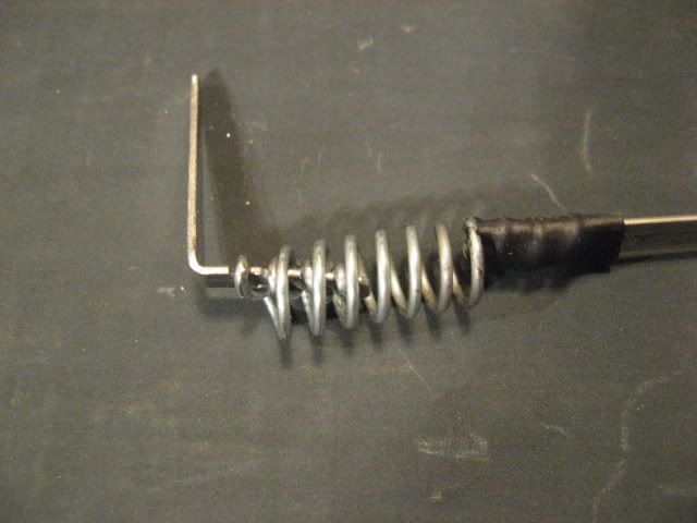

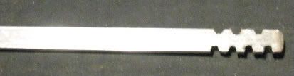

Now that you have you two pieces you will want to start cutting the alternating nothces into the ends. Start as close to the edge as you want the size of the teeth on the two pieces. Remember that this is the part we will be wrapping the spring around, so make sure it will fit in the notches nicely.
Ideally you want to make the cuts alternating so that one cut is in between the cuts on the opposite side. Do this on both pieces. I recommend if you have a slimmer wiper or a sweeper bristle you do less notches than pictured here. 3 to 3 or even 2 to 3. The thicker the spring the more stress the insert is going to have to withstand during wrapping.

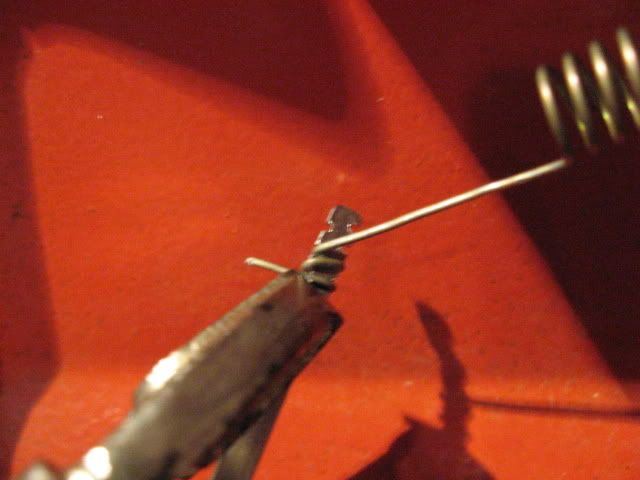

Now you want to take your spring and cut it to the desired length. 5 or 6 coils seems just about perfect, but depending on the spring strength and the desired effect you can use more or less. Remeber we are going to be uncoiling the spring, so you will want to cut 2 or 3 more coils on either side than you will want on the finished wrench. If you are trying to use needle nose pliers for this part, best of luck. It can be done.
Now you are going to want to straighten the spring. To do this take your smaller vice grips and clamp them on the spring as near to the tip as possible while still gripping some of the curve. You want to use the leverage of the vice grips to straighten the spring as you close them. Don't make them too tight or you will strain yourself and unnecessarily mar the spring. As you straighten the spring you can bend it into a straighter shaper using your pliers, this is where having a larger pair of vice grips comes in handy as you can clamp the uncoiled, but still very curved spring, and further straighten it with little effort. Otherwise you will have to use your two pairs of smaller ones in a joint effort to accomplish this task. It is not necessary it be 100% straight as we will be recoiling it around the handle and tip piece, but it should be straight enough as to not get in the way. You want both ends to be on the same side of the spring.
Now from the coil walk the notched blank end over end the desired length of straightened spring. 3 to 3 notches is 7 1/2 widths, 3 to 4 is 8 1/2, 2 to 3 is 6 1/2. You want enough straightened spring to start, wrap around once for each notch and end with enough left for a 90 degree bend at the end with left 1/2 width. To a large degree this is eyeballing it. It could be done reverse to possibly avoid excess straight spring, but then you risk a wrench that is tail high, low, perhaps even same sided and you will have little room to straighten more spring.
Roll up your sleeves men, because this is the hard part. Grip the approximated end of the spring tightly with one pair of pliers just below the first notch and begin to recoil the spring tightly around the blank. You can use another pair of pliers if you have to, but be careful to NOT put to much rotational stress on the blank itself. If you are using an especially strong spring you may need 3 pliers. 1 to grip the spring to the blank at the starting point, 1 for grip so you can tightly coil, and 1 to grip close to the loop being coiled to prevent excessive rotation. It seem like you would have to have 3 hands for this, but the bench will in effect hold the first pair in position for you as you coil.

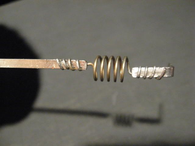

Continue to coil the spring in this fashion until you coil through the final notch, now lay the spring flat to the blank an bend midway through the width upward at 90 degrees.
Repeat this process for the top half of the wrench. Now grip the blank that is to be the top half of the wrench as close to the spring as possible, and bend at 90 degrees. Trim to your dimensions and you should have something close to this.

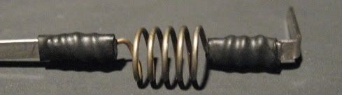

Now it only needs to be finished with heatshrink or tape.
If you decided to use a closed coil spring it could look like this.
Notice how even though it is a different spring and the handle orientation is different, the recoiled spring still needs to grip the last notch for a 90 degree bend.

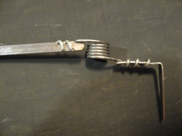

Here is a stronger, thicker, wrench made similar to the first only with an inverted coil on the tip side.
You will see the recoil is just as tight when done backwards, but more difficult to work around. I would advise against trying this one.

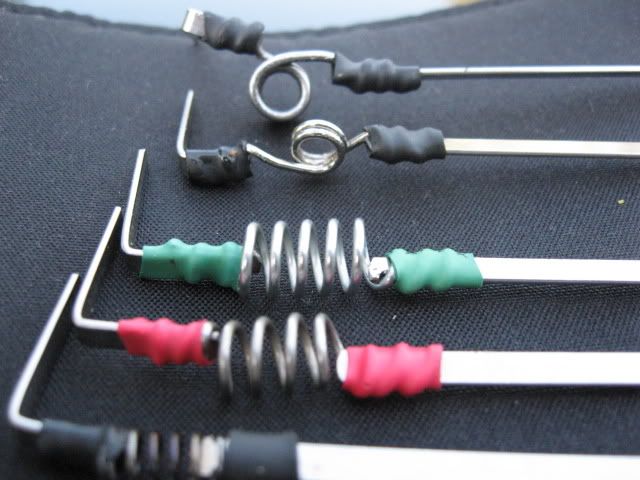

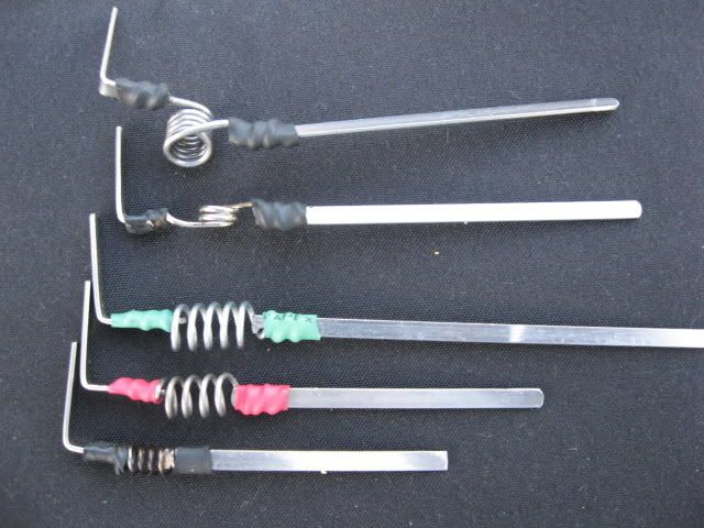

I was trying to wait to post anything else to give people a chance to ask questions. Try to get a better idea of photos I could take to clarify the process, but a week has passed and no questions. I must have been clear enough. Here's a few more I made up.
From the bottom up is a small spring used in a medicine cabinet door popper, the next one is a larger spring from a similar kind of cabinet hardware, above that is another stainless steel closet door spring, the next is safety pin with another half loop, then just to prove it could be done I made the top one with a mouse trap spring. It was difficult, but I think the stainless springs are a bigger pain. Notice how the handles are all facing up this time so your finger isn't resting on the edge. Much more comfortable and functional this way.
You can use any spring you want, but I would stay away from anything as small as the little one, or very thin guage spring. They still work for picking pins, but you need another wrench handy to spin the plug, which isn't very handy at all. Also, I made the safety pin wrench to take a shot at all those who would condemn homemade tools. The joke is on me however as it doesn't have very much spring to it. In fact, just put a twist in your wrench and it will accomplish the same thing. Stupid pin...

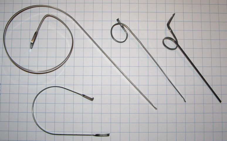

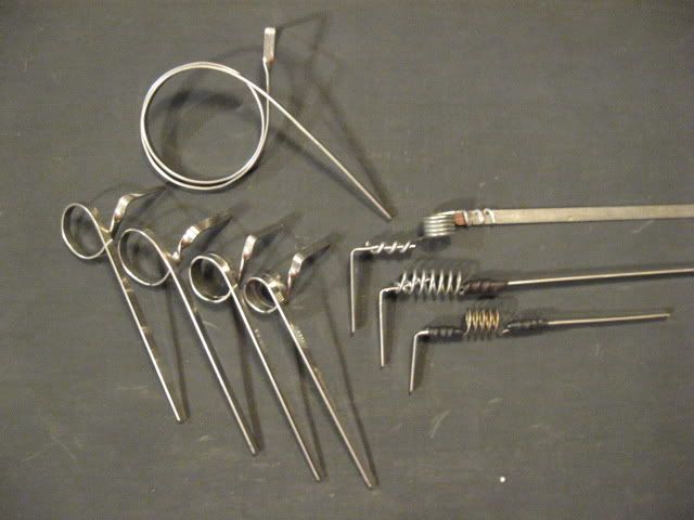

This tutorial was fantastic! After reading it I made some experiments. Two of these are my attempt to follow one of your examples, the other two are... errors? Ideas? What do you think about the U and the spiral wrenches?
I tried all of these, they work.
The spiral has an extremely delicate touch, almost null so is the right tool if you need to use a very soft touch. This one could be hard to carry on your person, but I practice only in my own house so this is not a problem for me.
The U is soft almost like a straight one. This isn't the world's easiest tool but is very small.
In the picture the grid has 1 cm space (1 Inch is 2,5 squares).
Do you think this ideas could be developed? If you're inspired, I'm not going to patent them 8)
