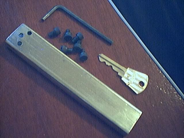

Postby Wrenchman » 29 Apr 2007 18:58
Impressioning Clamp
This is my suggestion!
It is less than 5 USD / 2.50 GBP
My problem now is that the lock is moving in the vice, so I need a bigger and stronger vice, the one I have is a 50mm hobby/toy vice, it is terrible!
I had the metal piece(a tool that belonged to the motorcycle), paid for the holes(4mm),(cuz I did´nt have the tool to do it myself) and the 6(six)(4mm)screws
It is working like a dream!
This one on the other hand cost £52.88 / 105 USD
Long live DIY

Postby butterboy » 8 May 2007 23:14
So I just had to try my idea so I went into the shop looking around found some 3/4 inch steel conduit/pipe, cut it to 7 inches, made a cut in the top so the key would fit and the pipe is the handle, drilled 3 holes on each side in a triangle, just like Wrenchmans tool.
I put in a blank and tightend up the screws, I only need 2 on each side, with the blank in the middle its very secure.
But how secure,we ask?
I put the blank in the vice and started wrenching , till the blank started to bend, so the key gave up befor the tool so im satisfide with it .
I also wraped the handle with some comfotable rubber.
Thanks for all the great ideas, it really helped me able to make my own.
