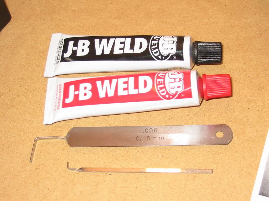

HOW TO: Feather touch tension tool
Postby Libris » 13 Mar 2007 16:23
I used some flux, but it didn't work Will acid flux do the trick?

Postby Shrub » 14 Mar 2007 6:39
Use plumbers solder and separate flux,
Make sure you sand the metal first,
Heat the metal up as hot as possable then start putting the spring in there and heating both adding a bit of solder,
Careful you dont over heat the spring if useing a flame as it will damage it,
I havent used my wrenches and to be honest i doubt i will, the first uk hobby picker with over 30 posts to pm me their name and address can have them to try out themselves, they arent perfect but for 5 mins work they are better than a kick in the teeth,

Postby NIC » 3 Apr 2007 12:02
Don't laugh. This is how i solved my tension trouble..
