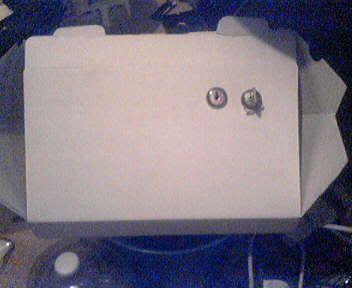

Lock practice board
Postby kb9tke » 25 May 2005 17:01
I just had a piece of that particle board laying around and just drilled holes in it for the cylinders across the top. Then I drilled a small hole from the top of the board down so it comes through the hole I drilled for the cylinder. After placing the cylinder in the hole I select a machine screw that is just slightly larger than the hole I drilled in the top and screw it down till it hits the cylinder and holds it in place. If I knew how to post pictures on this board I would post a pic for you. If you want, pm me your email address and I will email you with the picture attached.

Postby pip » 25 May 2005 22:13
mini lockboard
my mistake
2x8 lumber - 16 inches long - 3 locks fit on there nicely
