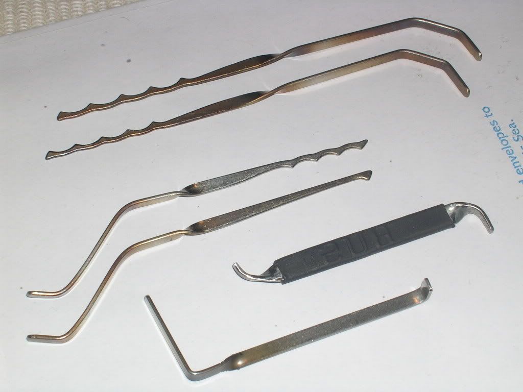

by Lokka » 27 Aug 2006 11:24
few pics,
the bogo set, (upper) picks are for a bigger and smaller lock,
so,2 different bogos in same set... everything is done out of windshield
wiper inserts, yup thats all. commets are welcome.

by illusion » 27 Aug 2006 12:41
Urmhh... The 3rd and 4th from the top look liek you couldn't really apply decent tension when using them as wrenches.
5th from the top looks like it's be usefull for turning stiff plugs.
I like your wrench design at the bottom - great thinking there.
As I say to pretty much anybody i can... Get some wet or dry sandpaper and polish the picks up a bit. It just makes them work a lot better.

by Lokka » 27 Aug 2006 13:40
thanks wrenchman and illusion!
yup!
about the 3rd and 4th it´s all true, its tricky but i can do it with them too,
wrenches are better (perfect for me)
in the first two.I usually set the tensioner to the... um, bottom in europe,
of the plug, so i just put em (3rd and 4th)in in a od angle, so its fine.
though i will bend them more to get them better.

by LockNewbie21 » 27 Aug 2006 15:02
Good stuff, but you donot need to heat the insert to bend, use a pncil or something round and bend the metal around it.
The key is use a round object to prevent stress fractures.

by Lokka » 27 Aug 2006 15:43
I have only been heating after all the possible bending, and i dont heat
them red hot, just a little, it hardens them a bit and i find it good thing to
do(they keep the bended shape better). im maybe going to try bending to 3rd and 4th, but im not sure yet,
ofcourse there is a risk..
i have been working with different inserts, some of them are good when heated alot, some of them are ruined, they act differently depending on
whatever thing that i don´t know.
thanks for advice though.
