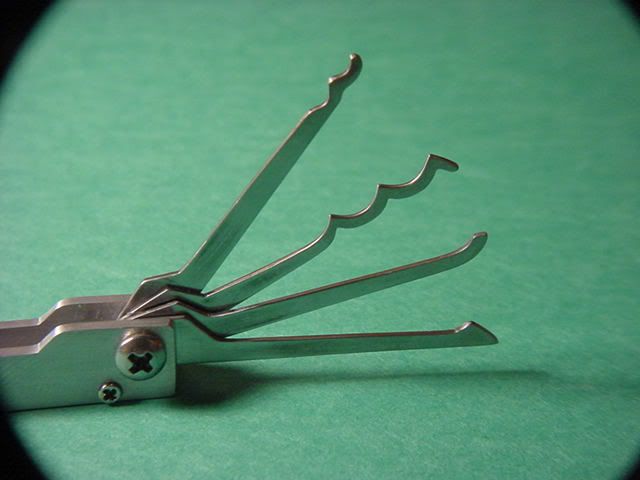

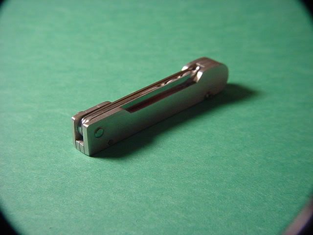

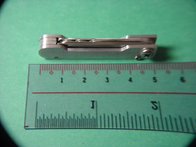

Postby Kaotik » 28 Aug 2006 19:10
I seen one of these in here, I believe it was a 12 year old JackKnife. Well this one is new, made by hand except for drilling the holes and making the picks from stainless with a dremel and files.
Made it from 4 pieces of .064" Aluminum sheet. I don't have access to a TIG or heliarc welder to weld aluminum so I drilled and tapped the holes and assembled it with some micro hardened screws. The 4 picks are a half diamond, a hook, a bogota and a snake.
Hope you like:

Postby p1ckf1sh » 29 Aug 2006 3:32
Wow, Kaotik, that thing is completely DIY? Very clean and good work.

Postby unbreakable » 29 Aug 2006 7:55
Wow Kaotik, I have to say that is one incredibley made pick!!
Beautiful work!

Postby Kaotik » 29 Aug 2006 17:41
Thanks for the very nice words guys. Very clean indeed, between working and doing other projects around the house it took me about a week, I took my time while doing it to insure a good job.
I love doing things like this, it relieves tension and keeps me busy. From all the things i've made I have become quite the machinest.
!*AMP*!, About the marketing question, I don't know. Maybe I should check to see if it is patentable.
From all the hours put into it, i'm not sure right now if i'll make another one. But if it gets popular, I can be PM'ed to discuss a price.

Postby scampdog » 29 Aug 2006 18:14
Nice one kaotic very well made,neat compact and look the biz.
