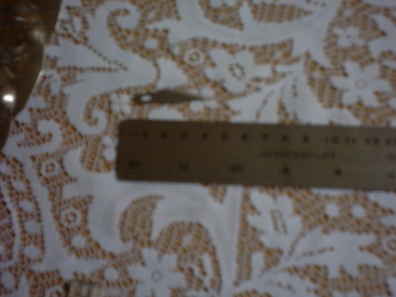

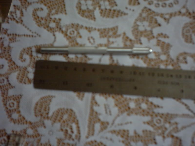

Postby Waldoonay » 5 Jun 2005 10:52
Here is the knife I was talking about, Im not sure if the blade is long enough to make a pick.

Postby stick » 5 Jun 2005 11:52
Doesn't look like its anywhere near long enough. Take chucklz advice, use windshield wiper inserts. If you can get a ride to a nearby autoshop type place and ask where they have thrown away their used windshield wipers, I'm sure the staff will be happy to help you out.

Postby NKT » 5 Jun 2005 12:48
Too small, by quite a way. Take a look at the size of a key for your length, and use hacksaw blades or feelers, or even the bits off windscreen wipers.
