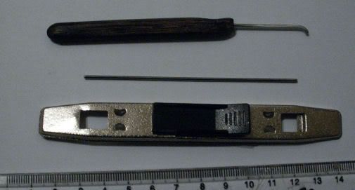

heres a pick i made from the inside of a lever arch file!
the part shown above has 2 sprung steel bars, one i made into the pick and the other is shown below it.
to insert the pick into the handle i drilled the hole using the spare bar as a drill bit so its a perfect fit.

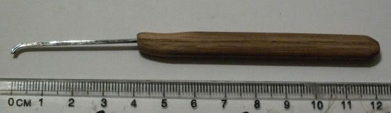

Postby raimundo » 18 Jan 2007 13:31
That photo by seejim shows an interesting handle, did you pound that metal into the wood before shapeing the pic, or is that some kind of plasticwood handle?
