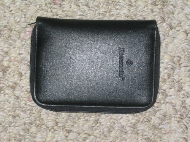

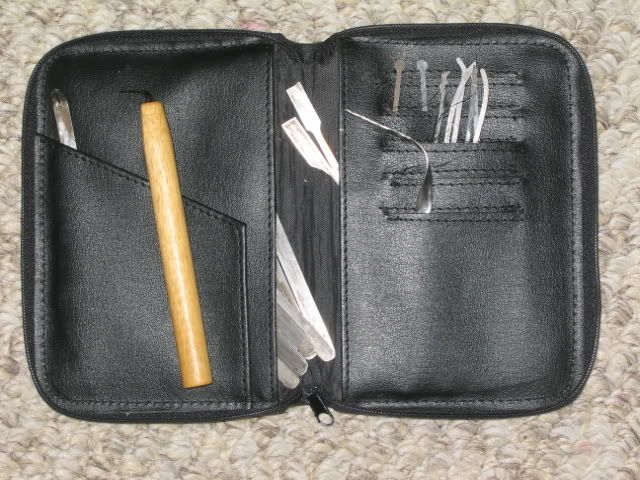

Next time you pay a visit to the dollar store, look for this case. I bought this for $1.06 after trying forever to make a decent case myself. Save some time and money if you want :roll: .
