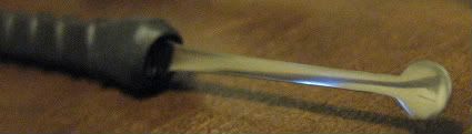

Postby ToolyMcgee » 7 Sep 2008 4:11
Criminalhate: Thanks. What you said about deciding to keep it simple early on in the competition kept me from loosing my marbles when some of my giganitic multipicks were to complicated to be anything but eye candy or ninja stars.
BrianPojo56: Gracias. Just representin' for the trash diggers. :mrgreen:
Mr_chris79 and LearningtheArt: Thank you for the enthusiastic encouragement guys. It's much appreciated.
ady1989 wrote:Nice tools man, the competition pick looks amazing. I got one question though: how well does it open locks? It seems like putting the half diamond and falle hook together would make it half as good as each, simply because it doesn't have the reach. I could be wrong, please provide some info on this.
Oh, you just said the magic words. Yes, it does seem like it would kill the function of the falle hook and it would if it wasn't finished in such a way that it is manueverable. It is sanded not just smooth, but with an actual shape that makes it workable even in an American keyway. I had lots of fun popping my shrouded brinks with it. It takes a bit of manuevering which I admit requires a bigger handle than it is outfitted with to get the most out of, but it is smoothly snaked through most locks using top tension. The space at the end of a slight falle rise is exactly the size of this half diamond, so as long as it has wards that can be manuevered through it doesn't have to slide under low pins because it can drop down in the keyway to get past them. Other than that it functions like a regular falle. It is a medium sized half diamond, so even though it works in every lock I own, it is most effortless in deadbolt sized locks. Mostly because to use stainless steel it had to be thicker to be stiff enough for my likeing, and also because most of the locks I use the falle on are large enough to accomodate the normal size. I find myself not flipping it over from the half diamond so much unless it requires a high pin set in the back, because the half diamond works so well on the "broken" shaft for setting the first four pins in any lock and it can usually drop in the keyway to get to the back as well. Make one and you will see how the slight bend gives the half diamond more space to set high pins next to lower ones. It isn't the ONE pick to defeat them all because like any half diamond or falle it has it's limits. It would be difficult to set a 0 next to a 7 in an American, but most short hooks won't do that either. It may look like a steeper sweep for a hook than it actually is because of the close up pictures, but it is actually about a falle safe 1 or maybe a little less. I've got a few steel ones made that are thinner with small half diamonds for tips, but the idea remains the same just on a smaller scale for really tight paracentric keyways and padlocks. I also feel it would be highly effective with a half ball instead of a half diamond, but sacrifice pin control for more manueverability.

Postby ady1989 » 7 Sep 2008 11:06
Thanks for all the info, you covered everything I wanted to know about it. I will give making one a try when I have some more spare time. The pick is very stylish, excellent work. Good luck in the competition, I still have to get my entry in but I'm very pressed for time.

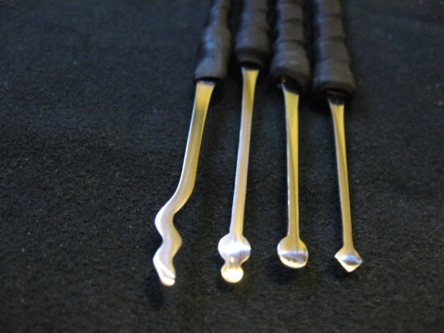

Postby ToolyMcgee » 25 Oct 2008 3:24
This is an old set I made about a week before I posted my first columbian royals.
For auto locks. I don't really find much use for them since my collection is limited, but I spent so much time polishing them it would be a shame not to show them off. :mrgreen:
I can't post new pics at the moment, so I dug out some more oldies. Hopefully that changes soon.

Postby ToolyMcgee » 25 Oct 2008 3:44
Oops. I accidentally hit the submit button instead of preview. Sorry the pictures are so huge. I don't know why the ball pick looks so uneven. It must be the reflection.
That's a little better, but it still looks off...
Oh well. I was thinking of doing a better DB anyway, and why not do another SB in addition. Like I needed a reason. Peace.
-Tooly

Postby raimundo » 25 Oct 2008 10:37
Try that ball pick on a dimple lock using it to insert the pick tip under a pin and then rotate the pick handle to lift the pin.
Once again, they look beautiful. the polish and the photography.
No im not pulling your leg, I mean it.
