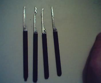

Postby GoodEyeSniper313 » 30 Nov 2006 1:22
i went out and got one of those drain snakes at home depot. it cost like $6. its 20' long. i made the first one and use heat shrink for the handle but decided i wanted it reinforced for better feel. so i added another laer on each side. it came out nice. i havent even started polishing these yet this is just the rough cut/grind. and i messed up the snake and its too big so i have to re-do that one

Postby Stray » 30 Nov 2006 2:01
Personally I get brick strap for free (HD cut it off of the bundles of wood when we bring them down, cut it in 5 inch strips and take it home) and honnestly I like it more than hack saw blades. (also I can make a pick and a tension tool out of one 5 inch piece.) I take the pieces that are not rusted up, stick a template to them with 3m spray adhesive or elmers, grind them down to shape with a grinder and dremel, then use the metal brush attatchment on the grinder to get rid of the black paint (actually gives it a nice finnish just at that stage too), sand it and then polish them.
Example
(still can use some polishing/touching up)
So Yeah for a free source of metal it works well.
