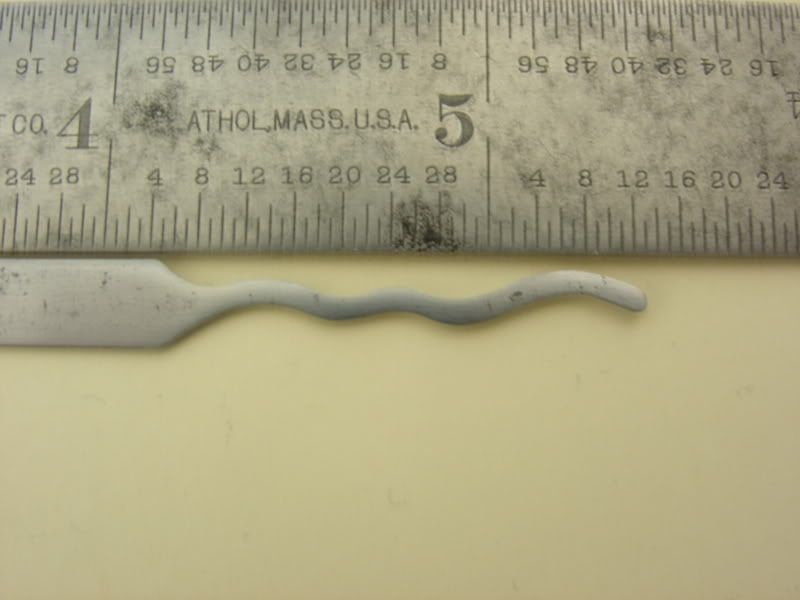

Postby Peter Martin » 29 Nov 2006 12:27
I knew there were easier answers. And I had superglue just sitting there in the junk drawer!
However, on a positive note, I can re-use my paper templates--not that it matters.
Here's my first attempt. My method seemed to give accurate results, but I will conceed, the less labor intensive (and simpler) methods might work better.
P.S. the metal stock has some rust pitting and defects--that's the black dots/areas. But it was good enough for a trial run.
