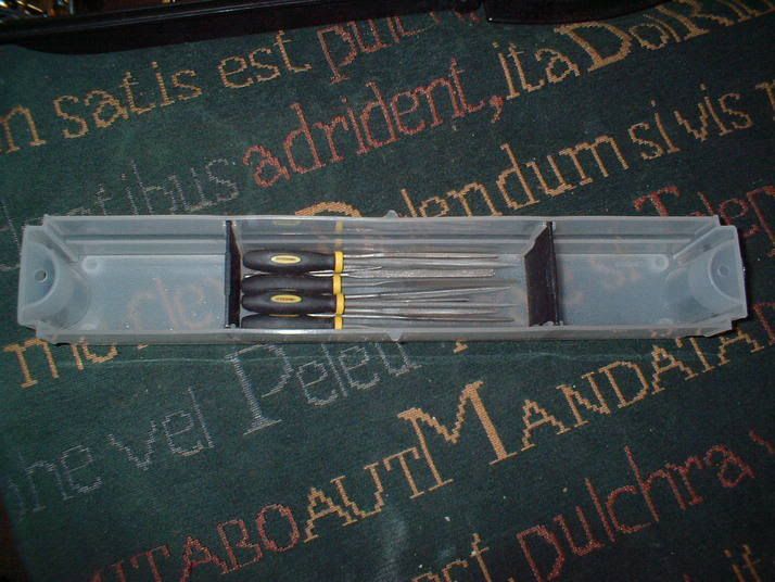

Postby illusion » 20 Jan 2006 13:49
Files:
[img]
http://i16.photobucket.com/albums/b25/j ... CF0046.jpg[/img]
sorry the photo is not zoomed-in but you should be able to get an idea..
The video Pyro made regarding grinding them will show you... it's in the FAQ section :)

Postby illusion » 20 Jan 2006 14:01
get the basic shape with the grinder, then use needle-files to complete it. that rake shape would be easy to replicate with a round file...
