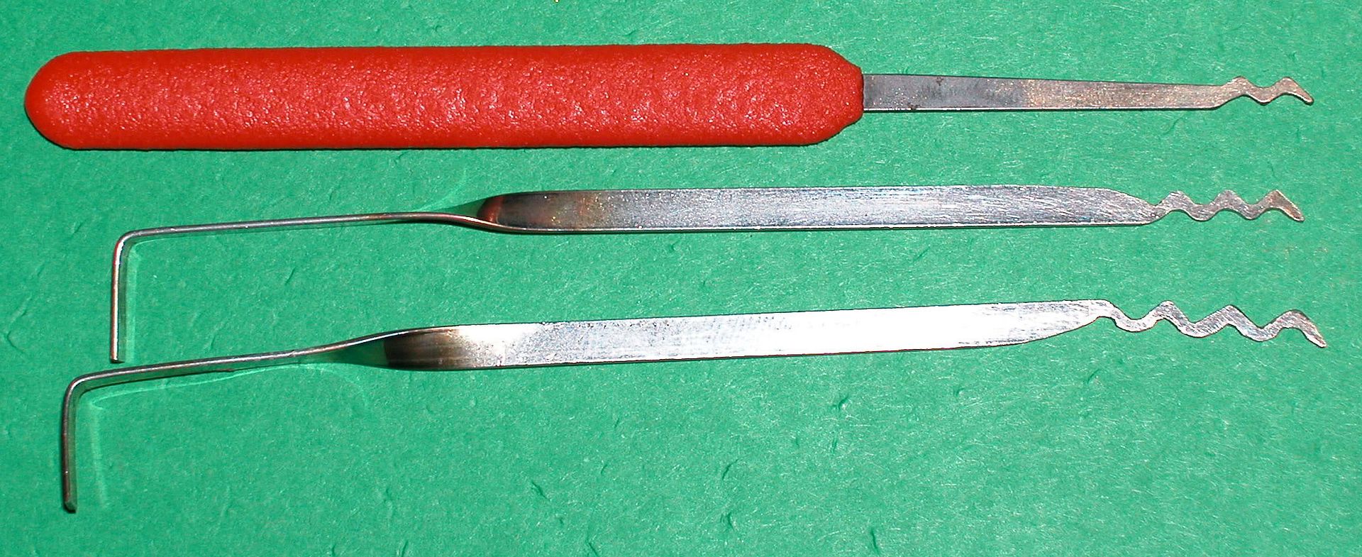

Postby Bud Wiser » 1 Sep 2006 20:29
Here is my first attempt to make bogota style picks. Rather then start a new thread I thought it might be fun bringing this one back to life.
The first one I made was a bogota attempt, pictured on bottom looks terrible, has weak points, but nevertheless works pretty good! I decided to try some thing different. And modeled my next rake after my favorite peterson rake. This one works on more locks.
In this photo I have a Peterson Rake for comparison on top, first pick. Second pick or the one underneath the Peterson is my second attempt to make a rake which I decided to design more after the peterson, and the bottom pick was my first attempt ever to try to make a botoga style pick.
The weak bogota pick I made actually works pretty good on some padlocks and doornob locks! My modified peterson rake is on of my favorites now. I'm definitely going to make some more picks. I just wanted to share what I have done so far so that others can see even if they are not perfect, they still work.

ok here they are, laugh all you want but they work fine :)

Of course with more practice I plan on getting better too. I want to try another attempt to make a bogota.

Postby VashTSPD » 1 Sep 2006 22:38
the top one looks like the popular W style (*I think*) rake that I've seen a lot of pictures of, I have one from SO. Except yours doesn't seem to have the weak spot a few people were claiming it broke at. how well does it work?

Postby Bud Wiser » 1 Sep 2006 22:43
VashTSPD wrote:the top one looks like the popular W style (*I think*) rake that I've seen a lot of pictures of, I have one from SO. Except yours doesn't seem to have the weak spot a few people were claiming it broke at. how well does it work?
It's my favorite rake, which is why I wondered what would happen if I added a third bump to it. I've beat the hell out of it, hey I'm still a noob, and not even the slightest sign of wear. I've only seen Peterson make it like this. I have SO, and HPC, but could not find one like this.
